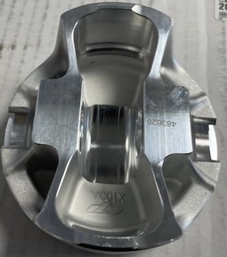

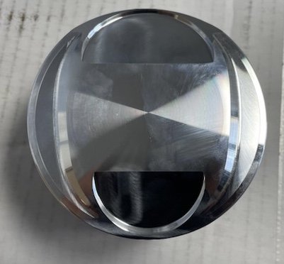

After 4 months….. FINALLY 😯 36FCEF1D-48B7-4CE0-86AE-F3F766A75F66.jpeg 3832E5C2-C4B5-407E-B818-C44F82272184.jpeg D9AEF933-6108-49D6-BC34-EC313288C171.jpeg 9556038F-1787-4EBA-8DC7-660B3FD11A14.jpeg

...Sounds like she'll be a great Drag & Drive ride for the future :giggle:. No coatings for the pistons?
. Nope. No snake oil on the pistons. 😁

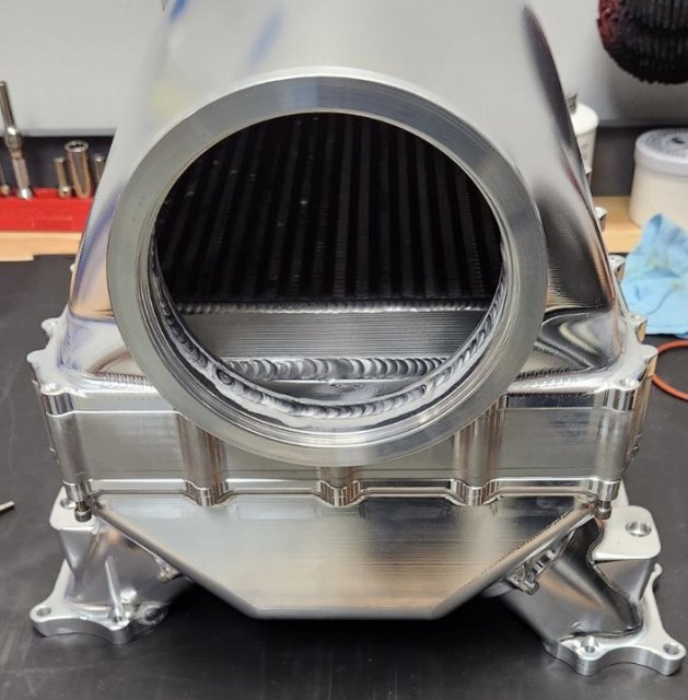

Huge Intercooler in this thing. 3.5” thick 😬. 27E9BE78-F3C6-4957-862B-A6E210D0677B.jpeg 2618CA5D-DDC9-464B-9F91-746C451D1B7F.jpeg F90312E6-3FD9-4707-A57C-8828E5ED5301.jpeg

Please tell me the runners have o rings where they meet the heads
I assume they do as this stuff is made for Pro Mod boost levels. I don’t have it in hand yet so I haven’t seen what’s going on there.

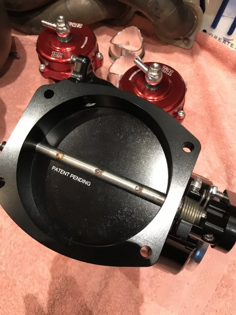

Some turbo bling came in today 🤗. I was going to start putting this stuff in a box but it looks too good on my office table. 674C0398-FE84-48F5-A1FB-A4E735A15A83.jpeg B295169C-1A92-47FE-8E2C-930BEC03266D.jpeg

You should take measurements or have someone do measurements of the turbo headers before you install em looks like an awesome design

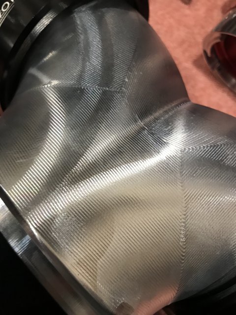

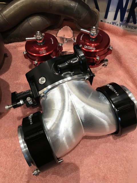

Thread Starter #1,379
Oh wow that’s billet cnc, the Y? Beautiful
Motion Raceworks. They make bitchin stuff 😵‍💫. 11DF4655-91AF-421B-B25C-DCC0C3CA6A19.jpeg 4B2F436E-4735-4ACE-93DC-BA15E1768F47.jpeg B2621674-2925-4F52-8AA2-592D8DFE524F.jpeg DD94EFF5-5A45-4147-A78F-6FBB8287C254.jpeg 3BED0691-09C0-47BD-BAA0-7F7C57FD8A36.jpeg D14834A2-E60A-44BF-A7BD-2852C353B6CD.jpeg
