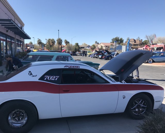

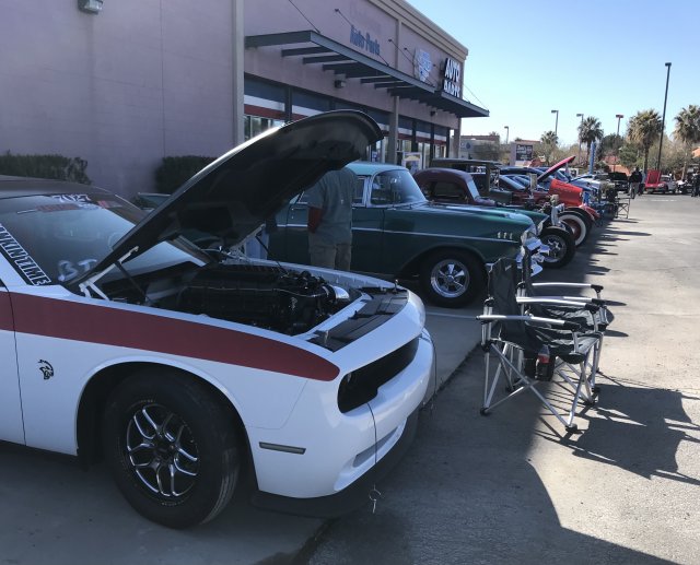

On the topic of not doing anything car related (fun), mine has been sitting in the trailer just as it left the track in Vegas. I was able to get it home today and decided to drive to the once a month car show. Big turnout! The children cried in fear, the men were humbled, and the women were… 😏 60BE31BC-A283-4016-83EE-34AAED10A982.jpeg EAE668E6-4B91-44C4-9FF8-6509B9E50B92.jpeg

Love the backwards Starsky and Hutch retro look its dope! Dam that drag pack sits up really high huh? Im guessing many here have no clue who Starsky and Hutch were but whatever......lol

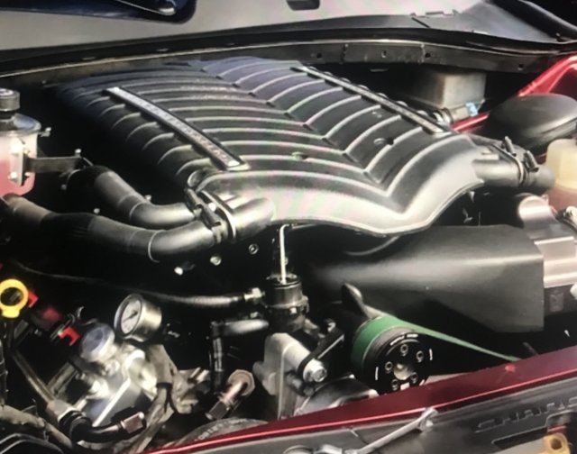

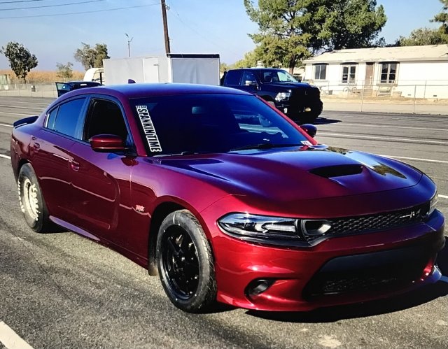

It’s still a 392 but built by Adam at Spankintime. E85, Forged Internals with Redeye heads and cam. 3.0 Whipple driven with the 6 rib serpentine belt. Hp90 trans, 3.09 gears, AAD, G-force axles with 15” conversion. Plans are to go to 8 rib pulleys to be able to increase boost. Belt slip is limiting now. C9A179AE-71FA-470D-9091-991BEB1133F9.jpeg

This car is a true daily driver and ran repeated low 9.3’s at 150. I’d have to ask again to confirm, but I don’t think it’s making more than 15 lbs on that 6-rib belt. Adam doesn’t dyno for talking numbers. For one thing, the shop is over 3000 ft elevation so there’s that, but….. it made well over 1000whp. Look at that skinny belt on the Whipple 10 rib pulley. 7C42E2E5-60F0-4D0F-9A23-7C53C7F6ED8E.jpeg

Thanks
I'm digging the Super Bee WB that should be coming out at some point.
But I wanted to know what a Scat can do.
Low 9 daily works for me.

how old is the blower, or is it different than current which uses oem by-pass (just curious)

It’s a newer blower that was ordered with the manual bypass option. Being a Scatpak, the pcm is for a NA motor. There is no electronic bypass tuning capability with that pcm so the manual one is the only way to go.

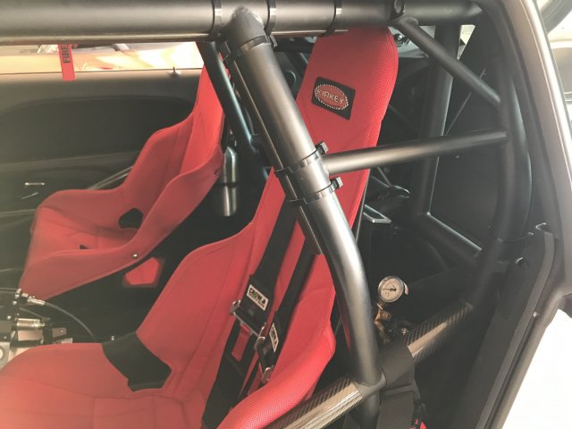

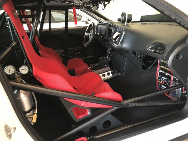

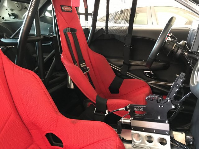

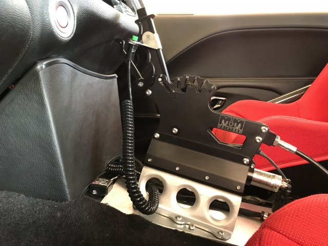

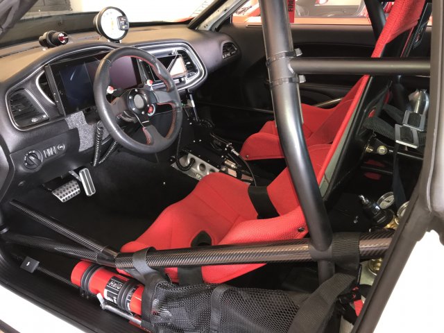

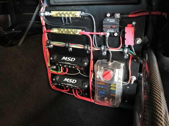

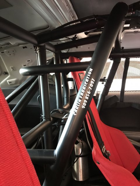

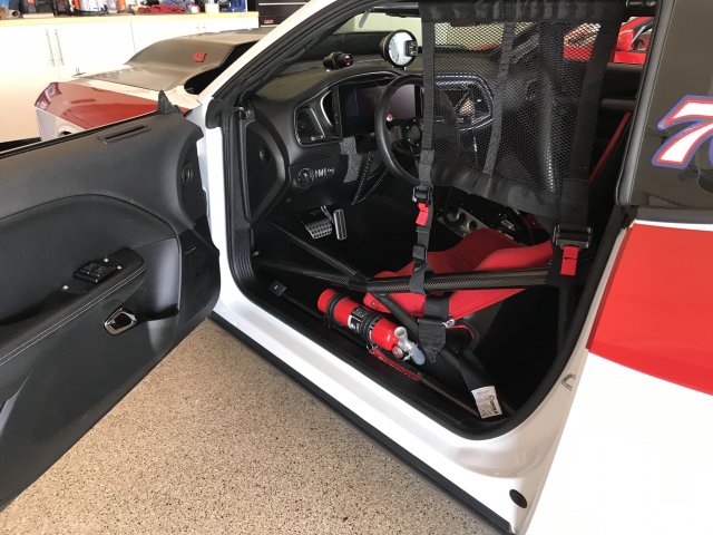

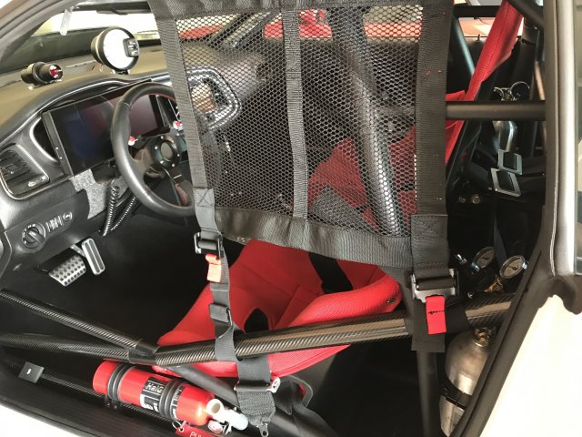

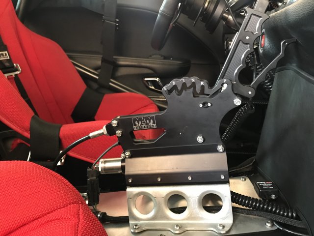

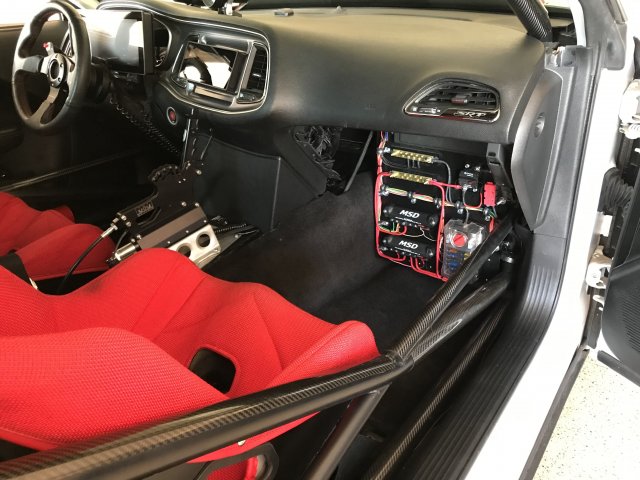

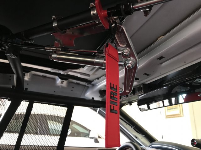

Interior has needed finishing for some time now with all the attention going elsewhere. I think I’m done ✅ DB901DF2-0EB4-4561-B278-E86EEBB5CF16.jpeg A9D02CC4-5A64-4ACC-993D-15C8E512A4DA.jpeg 05E76960-1DB9-4A07-9E32-6727FBADC327.jpeg 466F35BD-7F0C-47CD-9134-89E2491D8E04.jpeg 394EB42E-26BD-4D23-99C4-822E5FBBDD55.jpeg D3152477-64AE-437E-A964-AEAF6B179F8E.jpeg E132C8F2-73A3-47A8-B2F8-D288535B8177.jpeg FF59C3AD-5FF3-484A-8934-199C92F6096E.jpeg 75AE9A55-42D8-442B-A605-111EE9B4BE70.jpeg 2720422E-66EB-42BE-A295-99F8FA97A0AC.jpeg 0F680F6A-6FC1-400F-B62F-72AE2634A800.jpeg
1,594
3,974
bad-ass and neatly done

Looks really nice.

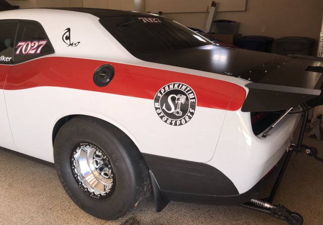

I thought I would run this by you with a question for the painter types. Cleaning the rubber off the rear is a never ending job with this thing. Being white.. it looks like shit all the time. The rubber from the Radial Pro is a unbelievable mess using goo remover. What do you think about this as a painted permanent solution vs the job of taping it like this before every time out? Leaving tape like this on for more than a weekend is not a option as it drys out and is worse than the rubber to get off. Plus…. I don’t think this tape will stay on at speed. 170 mph will peel it off. Second question is.. What is best to remove wax to prep this for paint if I decide to do that? B6E60226-986B-46AF-B0AC-B442AB7DC66D.jpeg
