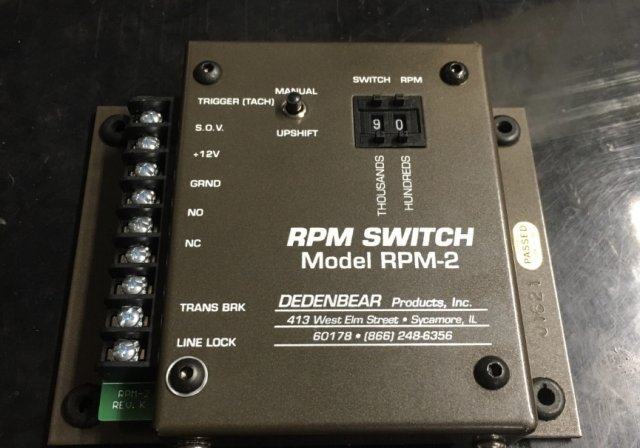

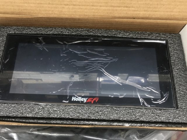

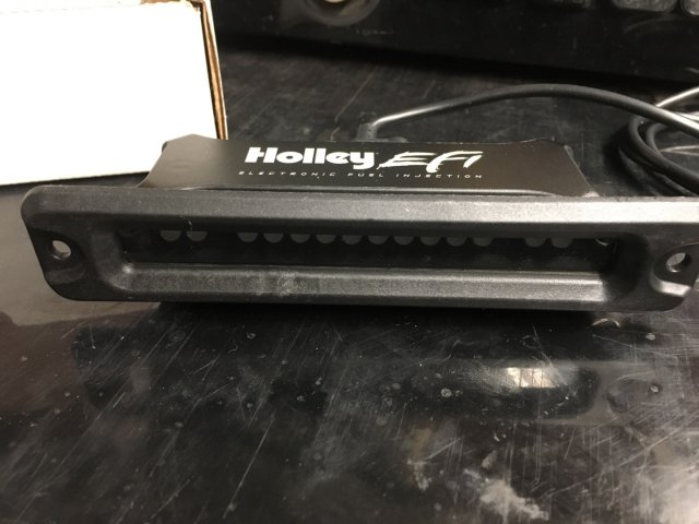

With summer coming and the days remaining to run any good air numbers dwindling..... there’s only one thing to do over the summer 🤫. Go big! 1B53E565-DAAB-4F3E-A243-EB1008CDD2BA.jpeg 67DE9084-48AC-493C-93F2-33BF91E2E798.jpeg 4968678E-7ADA-429C-906A-5484F48DDFCD.jpeg

Those eff systems are awesome to say the least . I will be working with one in my buddies pro street truck .
