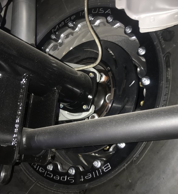

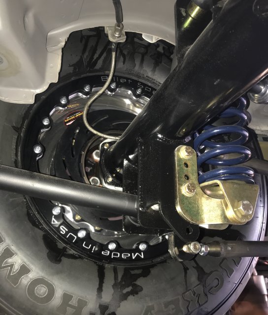

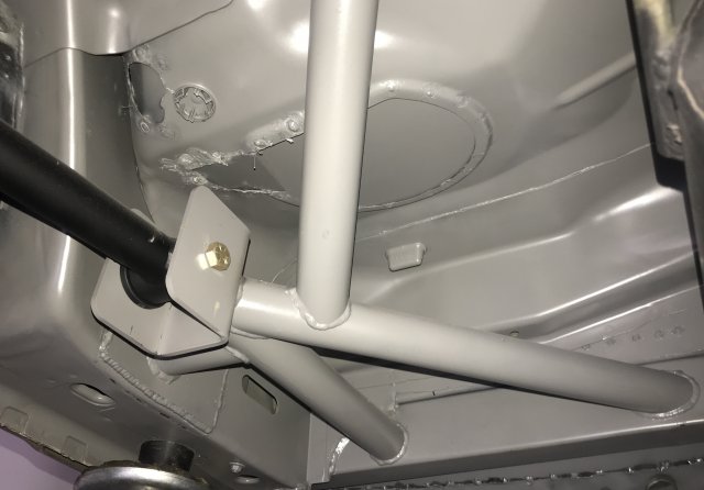

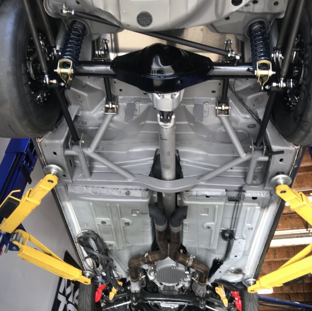

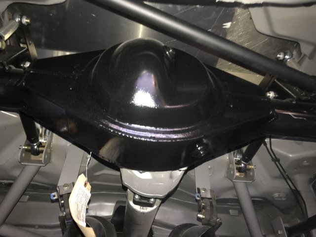

Now for what it looks like underneath all that... 17392EA0-8B31-4C02-9A87-A344078D794E.jpeg 5CF7B451-080E-429E-BB5E-7B2459D194EC.jpeg B50812A4-576C-40C2-AD75-AAF7DF75A425.jpeg BFA06D47-CD20-4123-850E-31656321AC3A.jpeg F2A55CEC-83AB-47BD-A700-1114D9CDDBD1.jpeg 828F3186-CE43-4487-B9B5-4BC2054EB9AA.jpeg 34C0EF1D-404D-4268-9B38-51F2BA670AB1.jpeg 6FDE9113-E8C2-416D-B41A-DA73B4FB9FE5.jpeg DE66C651-BFF4-4320-A468-A8B99FF7436A.jpeg

Very interesting to say the least . Im waiting on your review of the ride quality , launch , and associated stuff .
Btw what is going to soak up the sled big gulps now there is no carpet ?

Lol. Yeah I better have a good hold on my Big Gulp when I launch. It’s actually got drain holes in the floor so I’ll be ok.

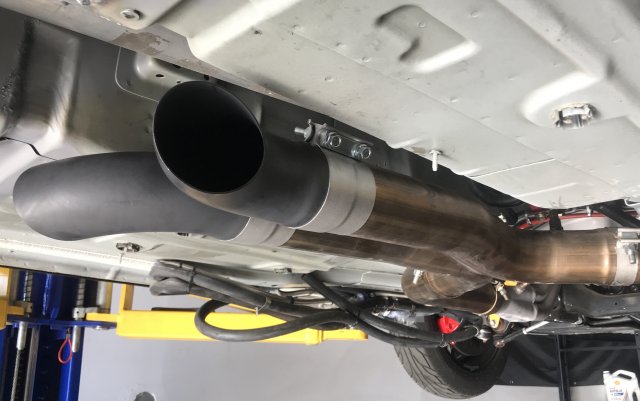

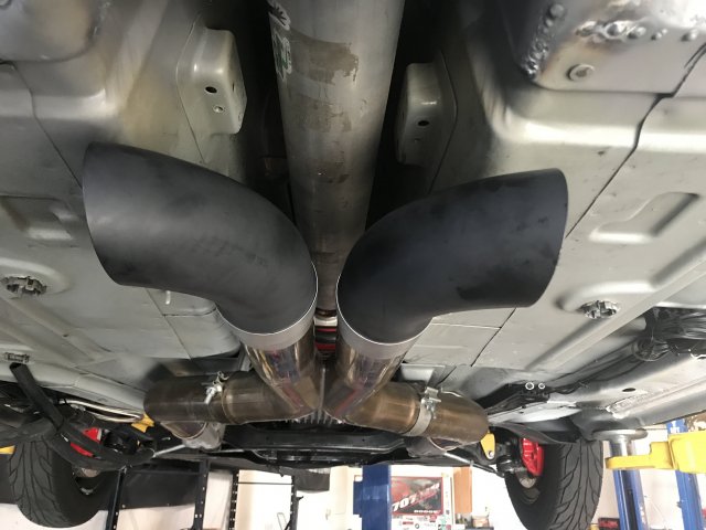

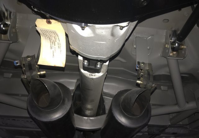

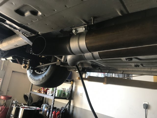

New 3.5” muff delete... 31D11191-B713-4D34-85CB-05C5C7107197.jpeg E12CE4B8-6842-4CF6-A063-F1226A62E4F6.jpeg 44345276-D0CF-46E3-ABBB-06D5AC33EC27.jpeg 6D73CB29-E383-4747-96DC-B4F909BC25BD.jpeg

Is the exhaust part new?
Is it louder than before?
The Flowmaster mufflers I had before were connected to that mid pipe with slip-on connections. I just took them off and replaced them with the turndowns. I can replace them when I want. What this did do is subtract 25 lbs. Those big muffs are heavy! Don't know what its going to sound like as we're still plumbing the fuel system to work with the new tank in the trunk.

The Flowmaster mufflers I had before were connected to that mid pipe with slip-on connections. I just took them off and replaced them with the turndowns. I can replace them when I want. What this did do is subtract about 20 lbs. Those big muffs are heavy! Don't know what its going to sound like as we're still plumbing the fuel system to work with the new tank in the trunk.

I was going to ask about the mufflers a few days ago. Some classes require them... looks like yours doesn't!

Thread Starter #630
Some sanctions and tracks do require muffs. The common practice is a very short mini glass pack like chamber that is about 3” long and 1/2” bigger in diameter than the tube. They do nothing and there is no requirement as far as decibel reduction. Just something you can point at and say... muffler. If necessary, I’ll add a couple of those.

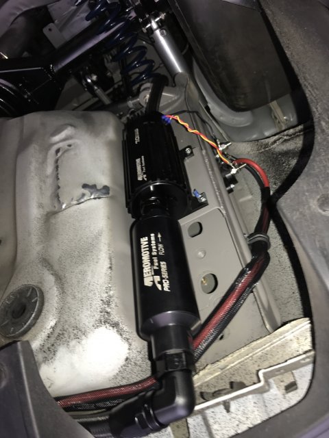

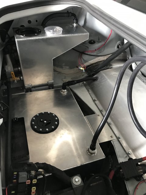

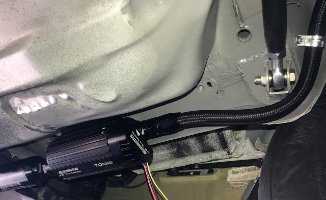

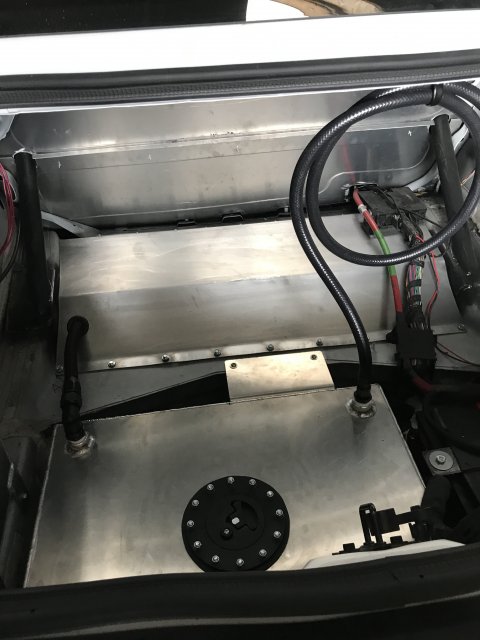

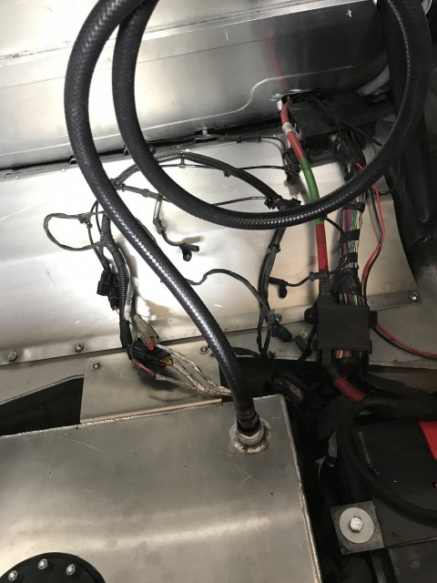

EE63A9EA-ED6C-4C18-9B12-6DA88AF7D147.jpeg Plumbing the new fuel system. Stepped the lines up just a bit over the Fore triple. 🤯 C4B6AD82-8F1B-4E2A-A474-700658263F4D.jpeg

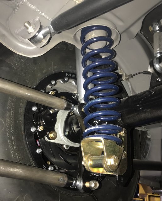

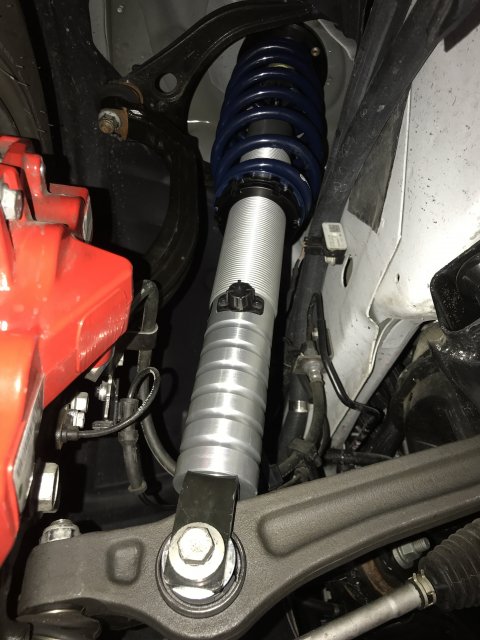

Thread Starter #638

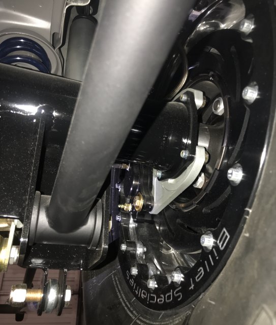

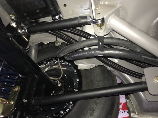

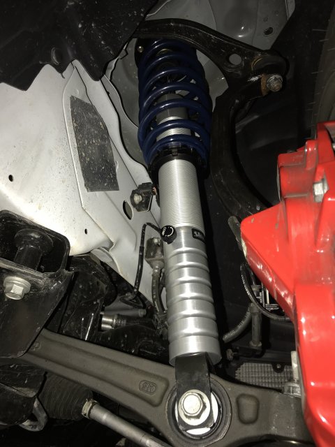

Some more shots of the new stuff. Fuel system and coil overs. Suspension is very soft and like any drag car is not designed now for cornering. We have it very low in the front. The springs have about 10” of upward travel the way they’re adjusted. The thing pulls wheelies in the parking lot now. 😂 379319EA-4B02-44B0-AB9C-FF75540AB7AB.jpeg 5B72B18F-5D3A-4F20-A9E8-2BE8B7ADC58E.jpeg 2D5627C2-8607-46D1-8B31-FB762D683D45.jpeg B6BDB641-5978-44FF-81D5-96A7592DC448.jpeg 3E1FC940-7B3E-408B-99CD-D23C08EC6A3E.jpeg

Thread Starter #639
We had to change out the front control arms to work with the front shocks. The 2015 DragPaks used a LC platform control arm so rather than grinding on the Hellcat arms, we started searching for the right one. Thing is.... it’s like every year is different. Fortunately we have the local dealer ok with delivering stuff and if it doesn’t work they just take it back. Took a few tries but the 2006 SRT 8 ended up being the ticket.

Thread Starter #640
Got some work to do on dressing up the trunk but it’s up and running now. Did you know that without the ABS wiring harness plugged in to the mothership, that you can’t bleed the brakes? That Holly is looking better and better. 🧐 52A05E01-C6D6-411C-8637-EDA6AF3A9FC5.jpeg CE529F12-D7A3-4090-B96D-9AB544CE0634.jpeg 22BE7CA8-0087-4E9F-9AAF-B89B5D4D00DE.jpeg
