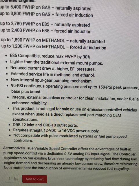

The StinkPak fuel system came in today. 7 gpm fuel pump, filters and regulator. Good for 2500 supercharged hp on ethanol. View attachment 33057
Nice . What is the max fuel pressure that pump will run?

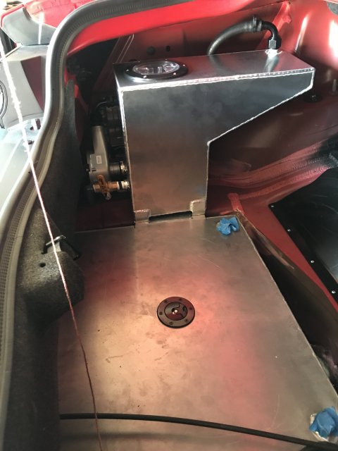

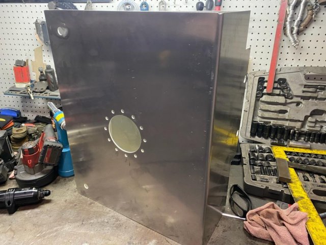

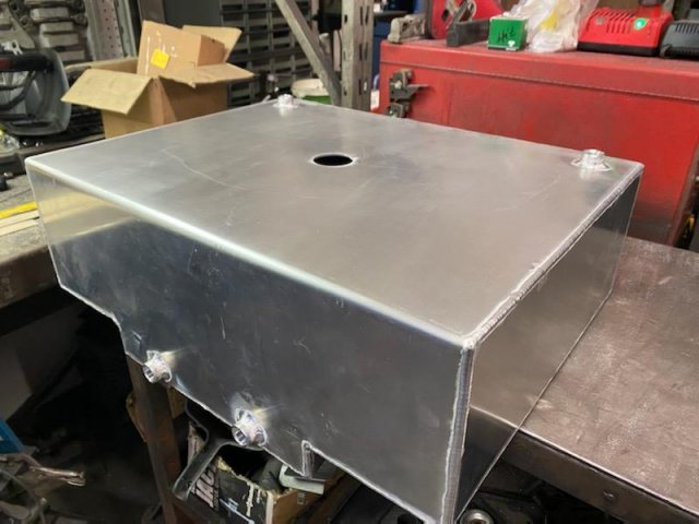

External. The 15 gallon fuel tank has a sump with two connections. One for supply and the other will be to drain the tank. This setup allows me to run less volume and not have any supply issues like we have with the drop-ins needing a half tank (weight) to not suck air. 79A8A3E9-06BE-44A1-858D-7656673B7B0E.jpeg 0E3D8F27-5B9C-4B1C-86AF-5FF60C5FF339.jpeg F3F1550B-7F7D-4134-BA9B-C01425AEEC4C.jpeg

I had a Fuellab 42402 back when... key-on and then RRRRRRRR as it primed my fire hose of a fuel line before I’d crank it over. I’m happy to not have an external pump anymore, but for you - it’s the right choice.

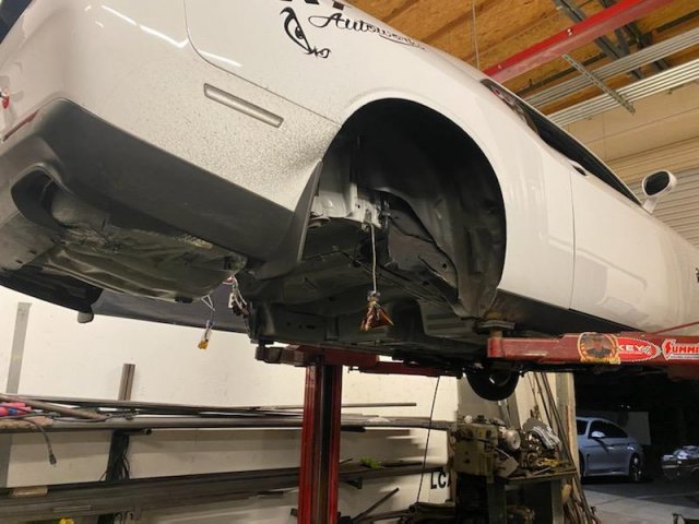

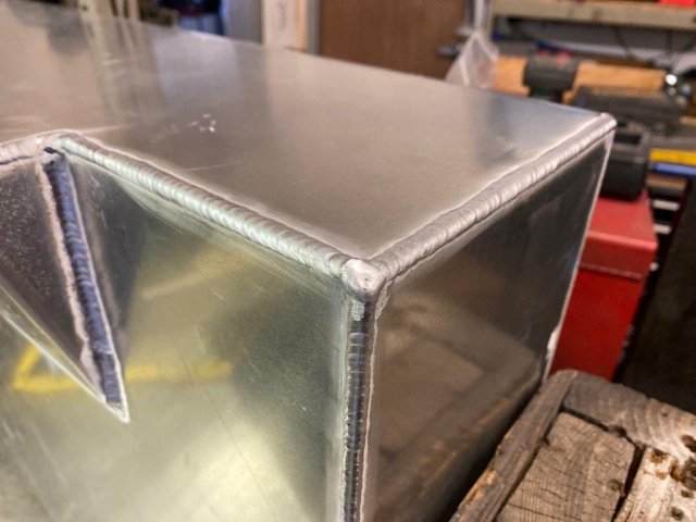

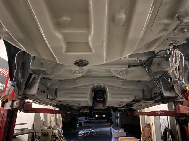

Weight reduction... 8D6C69AF-D67F-4D4D-BA8C-82999AEC42C1.jpeg BC1DA53C-EE00-447E-A887-B02CDCF4BE42.jpeg BC54A57A-3FC2-48F9-BF64-8361F3BAB27A.jpeg

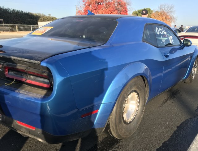

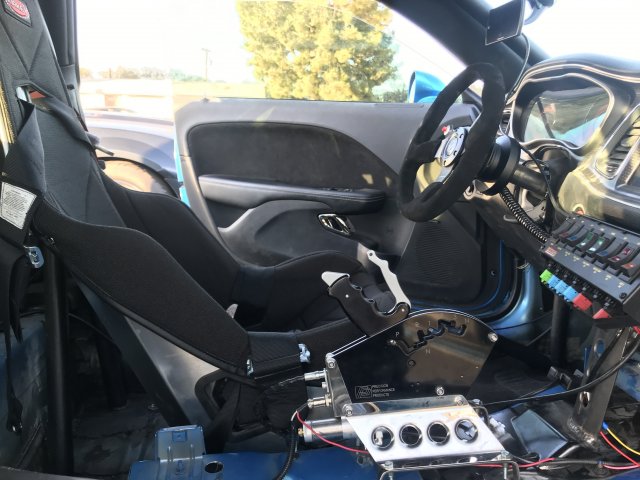

There are three of us crazy “out of the box” types here out west with me that are doing this. Joe is the other shop car (red widebody from Calif) ) and Brian (the blue one from here in Utah). Brian has really flipped his lid and gone full DragPak by gutting his 2020 Redeye. He got it on track for the first time two weeks ago in Calif at the Bakersfield event and made a couple get acquainted passes at low power just to see how the new rear behaved. He ran a easy 9.1 at 153 mph and said it was on a rail. He said it was the weirdest thing because it felt like he didn’t even need to have his hands on the wheel. I honestly can not say that’s how mine feels now (to say the least!). Looking forward to a more “planted” driving experience. I’ll add some pics of his car at that event. Got the spring height adjusted and it is looking real good. 3498A459-230A-46E9-9996-1E971D2F76E4.jpeg CDCF7E68-A36D-41C7-8AD5-6D24469F0170.jpeg 6A21713F-F355-4667-AC18-CAC01CC0AF45.jpeg CDF4F7BD-4938-4438-8F90-57A6777B91AF.jpeg
