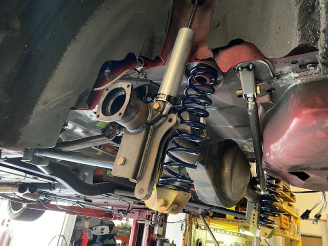

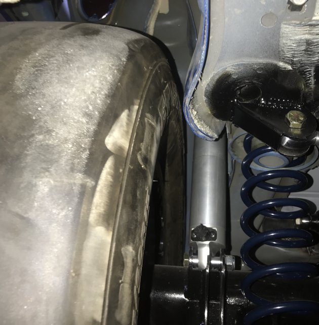

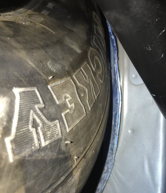

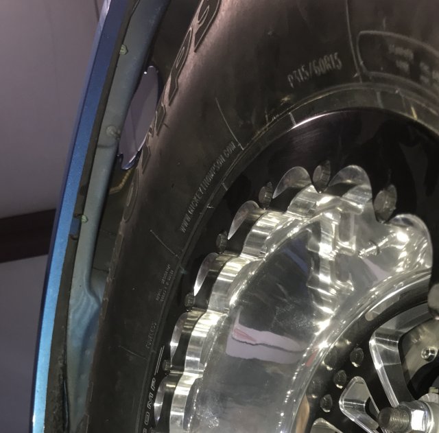

Yes it will. No more than mine. These are the same tire I’m running and to keep them inboard as much as possible, there’s a area that needs some aggressive attention with a saws all and the big hammer. Nothing that isn’t doable. 6A493DBB-6C60-4F58-BB5C-6091D39A98F2.jpeg 8C2C60D5-A360-46BF-B896-D2E1FF839B9C.jpeg E8A9B4E4-57DB-48C3-A1D5-72A67C913146.jpeg
11,025
That's not bad acutelly. I would have assumes some new wheel tubs

That is a good looking wheel! That additional depth looks great

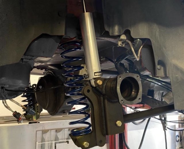

More pics of the 4-link. Damn. I’m starting to get antsy. Im starting to think about 7.90’s in a year from now. 🤔 E6478738-182F-48F0-B8B7-8AEE2A779325.jpeg 5A6BAB57-162E-4FD5-9F16-217AD1D060B1.jpeg B5669448-C1CF-4EE0-A9FF-68594431D2F6.jpeg

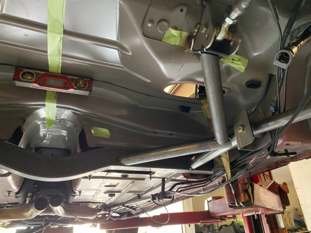

Update on the next phase. Finally made some decisions! DragPak rear end install starts on Dec 6. I’ve decided to make the car lighter and more efficient instead of chasing horsepower. The 3.8 Whipple is a pipe dream at this time and the best way forward is to drop 300 lbs and leave harder. A lot harder! I’ll be selling a entire 9” DSS conversion with suspension and brakes and wheels in December so if someone wants to treat themselves to a nice Christmas present... get ready. FDD3DF11-7D0B-4C4A-87F0-8424A3D02286.jpeg

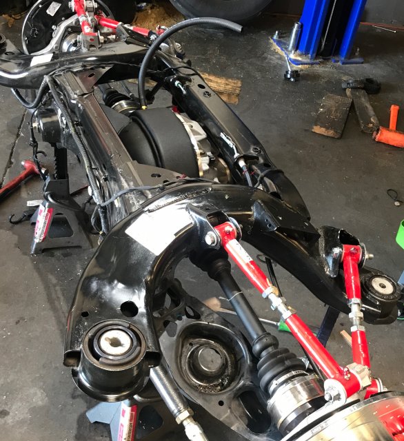

Don’t know what it will be exactly. 200+ at least just in the rear. Remember you’re pulling the fuel tank also and replacing it with a aluminum tank in the trunk. Plus With that you only have to run enough fuel to get down the track. None of the fuel pickup issues that forces us to run 10+ gallons in the stock tank. That’s 50 lbs right there. Wonder what this weighs.... 021366E7-939E-4F42-9A82-1BEE1A366812.jpeg

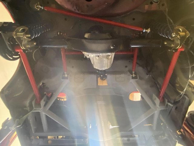

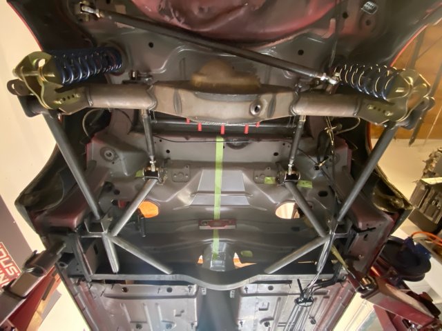

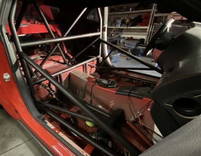

Within about two weeks now of getting this bad boy out of California and over to Arizona for the new trans and tuning. The cage is complete and just need to do the aluminum work. Going to have a lot better pictures for those interested, but here is one that shows how this thing ties into supporting the new 4-link suspension. 85D63B0D-C82E-487B-B54C-9597EAE48662.jpeg A4E59B79-BAA0-483F-89FD-7F57D219F366.jpeg
