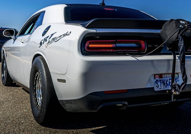

345/30/20, 20x12" wheels, Phillips Lil Devil Flares.

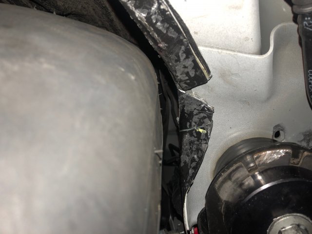

315/60-15 M/T Pro. Absolutely the biggest thing you’re going to get in there without ripping out the entire inner fender structure. E89A99F6-6B86-41F3-A177-F085C93A3C6D.jpeg 667E88C0-D6F7-4C69-AB1B-F49273D4E90E.jpeg

I'd be mindful of tire brand size variability. Continental ECS 305/35/20s on 10.5 PKAD HR5s required plastic liner trimming on my 2017 Challenger. I still use 3mm spacer too since so close even after trimming.

Ever so slight rubbing of the wheel well liner. Have 8mm spacers & lugs. Need some lug nuts and it's in!

No work inside the fender well, since the flares give you more width, the wheels have the offset to push them further outside the fenders.
