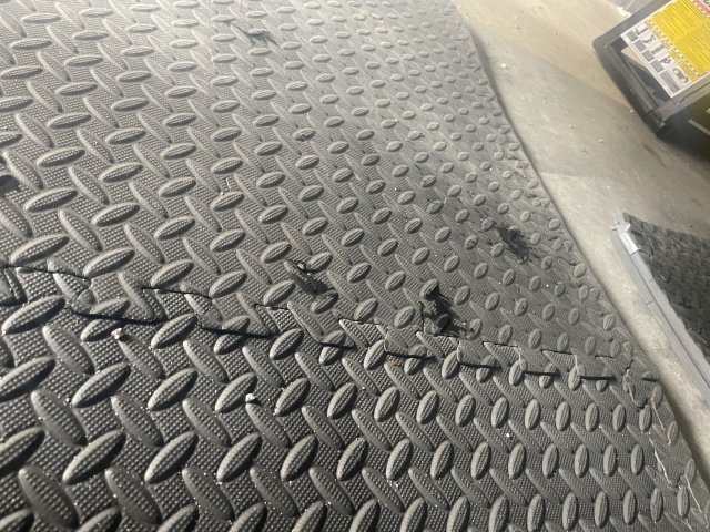

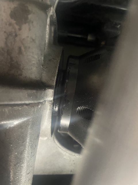

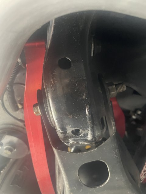

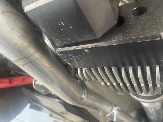

RIP diff, you will be missed. Based on the fluid Im either guessing the axle broke or the diff shattered the seal. Place your bets below on what it is. Ill post a teardown around 3PM today. Under the car doing an autopsy as I type this. Also, am I fast now?

My bet - broken axle. You were able to get it home?

Broken seal on the pinion

Yes, exhibited symptoms of crunchyness when making left or right, when making a right into my garage it went boom... Gonna look for the ring footage now.

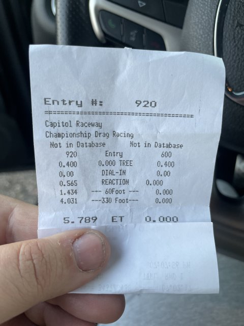

No wheel hop, in the newest videos you can see just good solid launches.

The car was absolutely dialed in for 9.5 index racing and I was hoping to make a killing season opener at the MSHS in the Roc. @Jon-MooredPerformanceLLC and I have been working our assess off to get the car to be consistent. Him doing the magic on the tune side and me doing the mechanical aspect.
Seems the axle is in there good, the splines are twisted. It is Sunday, I don't want to work on the car so it will sit. Just sitting here myself before my morning coffee and thinking about how disappointed I am in the GForce axles. These are supposed to be the Billy Badass of axles but yet they can't even hold up for my car. It also has me borderline depressed cause I already took all my vacation this year and spent it on MSHS events, planned hotel booking and travel, made sure I had a dog sitter, etc.. and here I am looking at another 2-3k for a diff and replacement axles.
