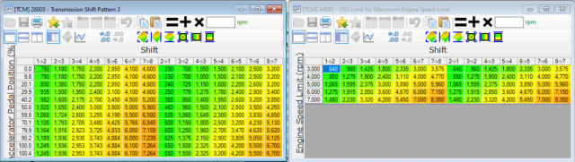

I have banged off this limiter and the car has fallen on it's nose, not because it wasn't doing it's job but because the car is in a failsafe mode when it hits these. I took the WOT values for these and multiplied them by their gear ratio:
1->2 2->3 3->4 4->5 5->6 6->7 7->8
6971 7002 6972 7014 7031 7000 7014
If you've take your trans to these values, this is a NG situation. Either command more line pressure or command the shift earlier. If anyone is shutting down at the track and they are not data logging then assuming it is this table is hearsay. I've banged off the rev limiter and it will tell you exactly why it happened, you are hitting one of these and yeeting your trans.

I skimmed through all the post, but as explained, shift scheduling is based on output shaft speed. Divide desired shift rpm by gear ratio (of the transmission)
for example, 1st gear ratio is 4.7 so if you want a 6250 rpm shift youll divide the 6250/4.7=1329.787 so for the 1>2 shift, take where you want pedal position to be wot (I use the bottom 3 rows) and enter 1330 into those 3 cells, repeat for gear ratio vs desired shift rpm for the remaining gears. 6th is 1:1 so it would be desired engine rpm, and I personally dont like shifting into over drive under wot, so I leave those alone but they could be maxed out as well.
Depending on shift rpm you might need to raise the trans max rpm as well to avoid limp mode, but I believe that is 7560 stock.
Ill be happy to send you a copy of my file in my personal car for reference purposes.
Also, you can log aggression pattern to see what pattern your in . I personally change all the aggression based schedules to the same numbers so it always will do what Im hoping it will under wot conditions.
Shift pressures are a whole different lesson, but again, as every tuner is different, I adjust my normal mode as well as I like a firmer shift daily driving as well

You too have the 1-2 shift at 1500. It seems like it only hits 79.9 percent in the 1-2 shift. Anything above that is irrelevant.
Thanks for pointing that out. I generally lock out 1st gear at the track and must have not set that shift back correctly. That explains blowing throught the 1>2 last track outing :eek:
It was supposed to be 1400. Correcting now

@fumanchu182 So taking time on the car today. I looked at the max engine table. Can you show me your math on that? This is what I convert it to. With this being the case this table is a limiting factor
Output shaft speed
Engine speed
Everything is based off output shaft speed.
8hp90 gear ratios are
1st-4.71
2nd-3.14
3rd-2.10
4th-1.67
5th-1.29
6th-1.00
7th-0.84
8th-0.67
I personally dont like high rpm shifts into overdrive so I only adjust 1st-6th
commanding a 6200rpm shift would be
1st 6200/4.71=1316.348 so OOS would be 1316.35rpm for 1>2 shift
2nd 6200/3.14=1975.522 commanded shift point would be 1974 for 2>3
3rd 6200/2.10=2952.380 commanded shift would be 2952 for 3>4
continue for the rest of the gears

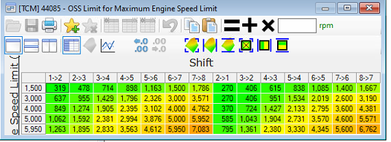

Output shaft speed
Engine speed
When I look at my Max Engine Table (44085) it is not limiting my shifts at all:
How is the Max Engine limiting your shifts or what evidence from a log do you propose supports this? When you hit a redline or blow past it and put the car into a safe mode, HP Tuners will tell you when you log it?
Ok now this is getting fun. Your values are much higher than mine stock. I just checked @vortecd stock read from his 2016 and it matches yours. Look at mine below
Also I have never had any shift issues. So I haven't logged for it. Above I said i've seen a few people at the track have issues especially after the burn out and I wondered if this table was the reason.
