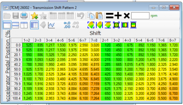

Wow. As a tuner its wonderful to see the helpfulness of this forum!
I skimmed through all the post, but as explained, shift scheduling is based on output shaft speed. Divide desired shift rpm by gear ratio (of the transmission)
for example, 1st gear ratio is 4.7 so if you want a 6250 rpm shift youll divide the 6250/4.7=1329.787 so for the 1>2 shift, take where you want pedal position to be wot (I use the bottom 3 rows) and enter 1330 into those 3 cells, repeat for gear ratio vs desired shift rpm for the remaining gears. 6th is 1:1 so it would be desired engine rpm, and I personally dont like shifting into over drive under wot, so I leave those alone but they could be maxed out as well.
Depending on shift rpm you might need to raise the trans max rpm as well to avoid limp mode, but I believe that is 7560 stock.
Ill be happy to send you a copy of my file in my personal car for reference purposes.

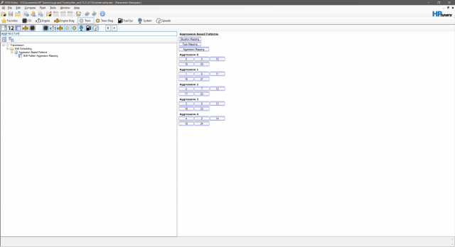

Also, you can log aggression pattern to see what pattern your in . I personally change all the aggression based schedules to the same numbers so it always will do what Im hoping it will under wot conditions.

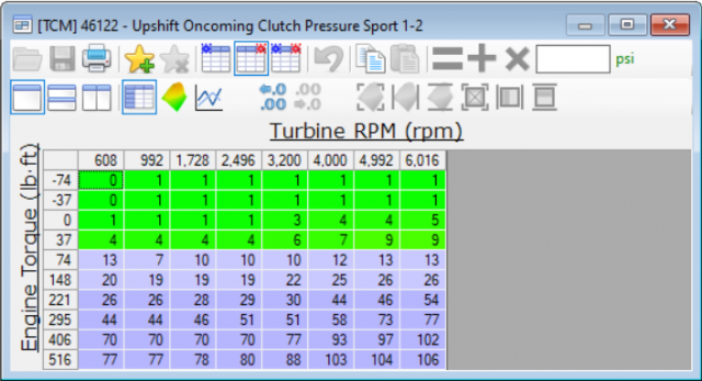

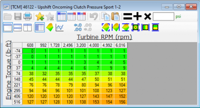

Shift pressures are a whole different lesson, but again, as every tuner is different, I adjust my normal mode as well as I like a firmer shift daily driving as well
This is my current tune I daily drive for anyone to reference if they would like

You too have the 1-2 shift at 1500. It seems like it only hits 79.9 percent in the 1-2 shift. Anything above that is irrelevant.
Thanks for pointing that out. I generally lock out 1st gear at the track and must have not set that shift back correctly. That explains blowing throught the 1>2 last track outing :eek:
It was supposed to be 1400. Correcting now
