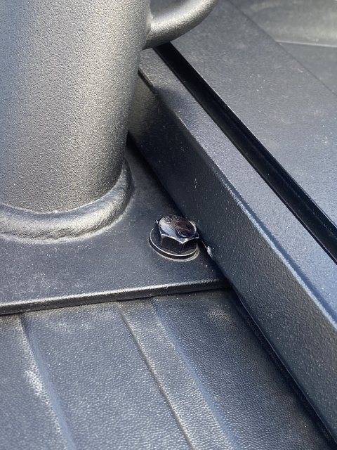

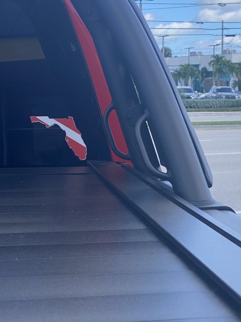

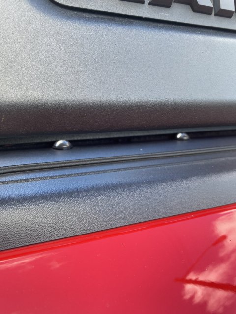

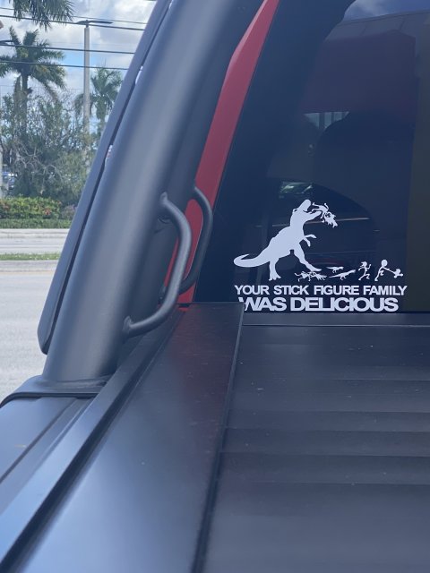

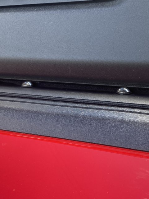

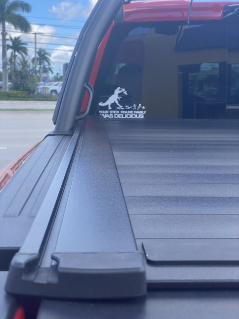

It’s a tight fit, the two bolts for the ram bar closest to the cab are hex head. I changed them out for a stainless low profile button head. That’s all it takes to get the clearance for the power cover. That little extra millimeter of room. I did the install solo, wasn’t terrible. I’ll show pics tomorrow

just for my Hellcat homies

That's what I thought, but you solved it for your case.
My hard cover rolls up, but on the top side, so I think it would hit.
Yeah the roller models aren’t gonna work with the angle of the ram bar and the handles that jut out.
