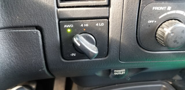

Here is my Durango switch. Guess it is always in AWD? Bought it to flat tow and didn't realize AWD until after the fact.
Excuse it being dirty.
Not always. Not if you put it in 4Hi, 4Lo, or Neutral, right?
Can't remember if putting it in Neutral made it flat towable or not, but I don't think so.
5,857
38,812

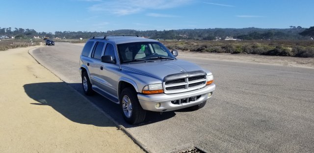

Actually yes, putting the transfer case in neutral allows for flat towing as per owners manual. One shop made a statement about it being AWD and more complex...but I don't know. Bought at 88,500 miles now at 104,000 miles. Been a great adventure car on our camping trips. Actually love driving it (not as much as Hellcat though).
5,857
38,812
Probably have flat towed it 12,000+ miles.
16,918
52,983
What year is it?
5,857
38,812
2003 Durango R/T...last year of the 5.9 magnum V8, at least for the Durango that is. Built on same chassis as Dakota.
