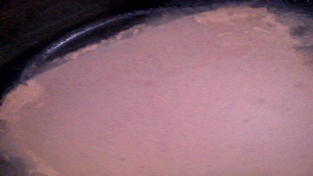

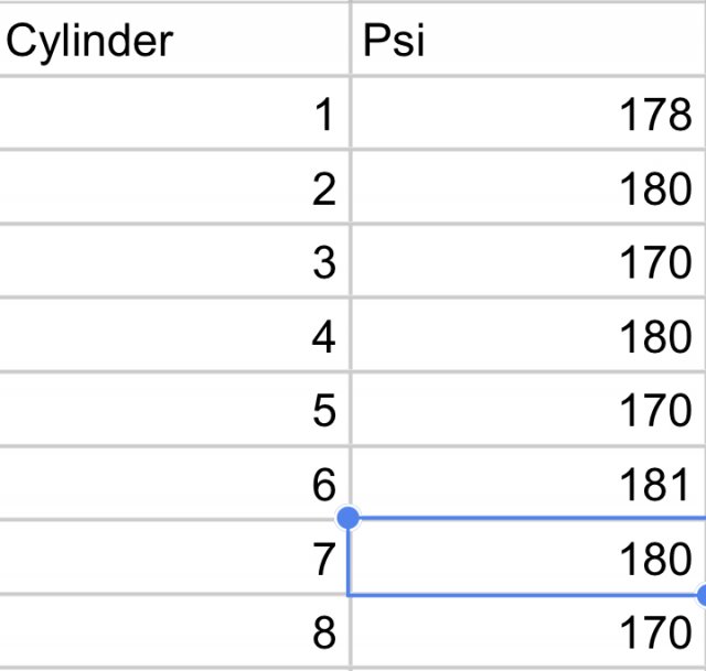

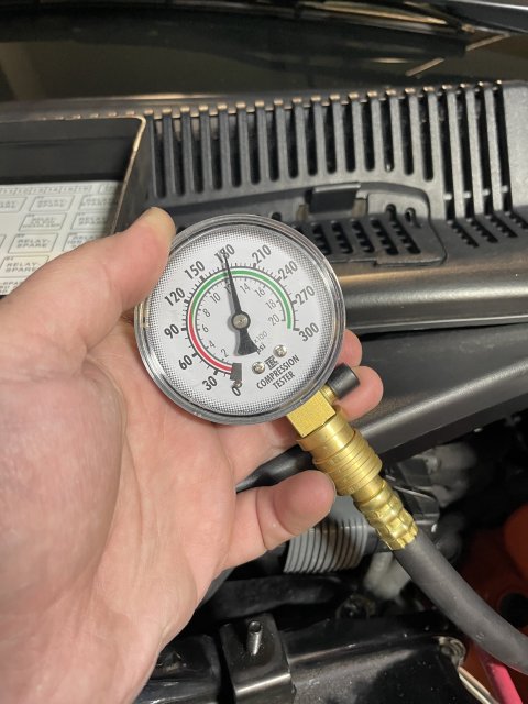

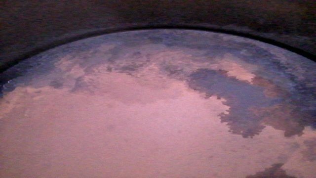

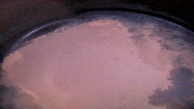

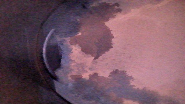

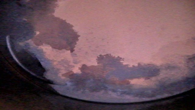

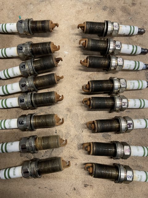

7F95CB63-938A-4208-B6BE-947437925CDE.jpeg AFF3C892-D639-4A99-A319-3E0E338F76B3.jpeg ACED9A47-A1F7-41FE-A70F-F930F952B6F7.jpeg 6A71536D-54FE-42F2-8205-513D42588180.jpeg 147BAD54-2A27-4FF6-810A-4C4B64A30808.jpeg 045A1D46-2B8B-4236-99E8-94807B620225.jpeg 3EE22825-9E41-47F1-B627-4B56F9BA7007.jpeg
All cylinders on the left side are healthy. @Speedy! and I were worried about #7. Other than boostane being found, all is good. Time for more boost! Also have new knock sensors just in case.
obligatory puppers post
1,864
5,711
There's nothing like having an emotional support pup near by cooly watching you while doing a knuckle skinning exercise!
16,919
53,001
View attachment 53848 View attachment 53849 View attachment 53850 View attachment 53851 View attachment 53852 View attachment 53853 View attachment 53854
Nice, minimal if any real carbon deposits.
How many miles on this motor?
4,087
10,234
Thread Starter #51
sixty thousand, and sixty thousand more to go!

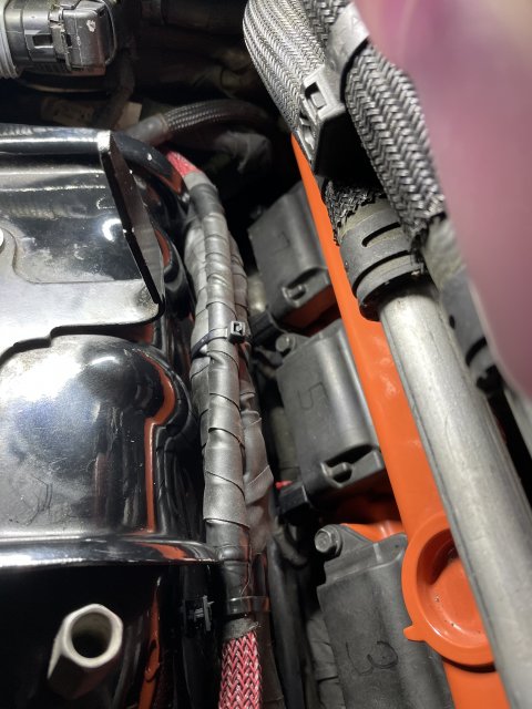

Doing the plugs in my RT was a bitch….this looks like a during winter project to be able to walk away from when frustrations rise.
I can only imagine what a dealer would charge to do them.
Minimum... $500.

It’s a long winter here…I’ll take my time for $500…..Mind you it will be a while before mine need to be done.

So after evaluating the data, the knock is not coming from the cylinders. On first drive it was smooth. Still going to replace the knock sensors but I’m glad plugs are done.

e85 should clean that right up:)

gave up for tonight pounded three beers in a half hour. My back hurts. Two more cylinders tomorrow. Local beer…
Yeah, that's what is the worst to me most the time - is my back - after leaning over into engine bay for a while it starts to hurt & can barely straighten back up, then hurts for 2 > 3 days after, & tearing up your hands sucks too !
