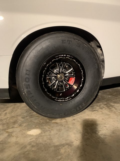

Got the new rear wheels and tires mounted up. 0B1A899C-2B81-4BC8-9DF1-8F4D0B151AEF.jpeg

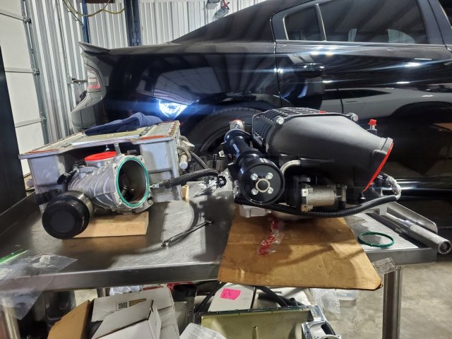

Thread Starter #42
Update on the build: Car is in the shop having the maggie installed along with 1700id injectors, Big Jon Racing Idler kit, Fore Triple Pump, Gearhead Fabrications 108mm TB, Forced Induction Interchiller, light weight frt bumper support and will be tuned for Ignite E90

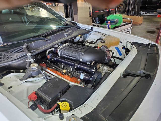

Thread Starter #43

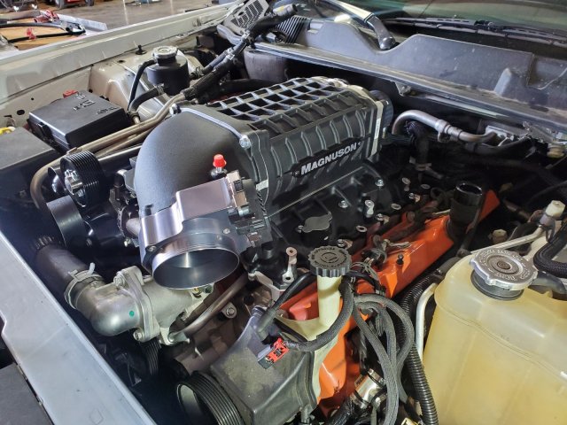

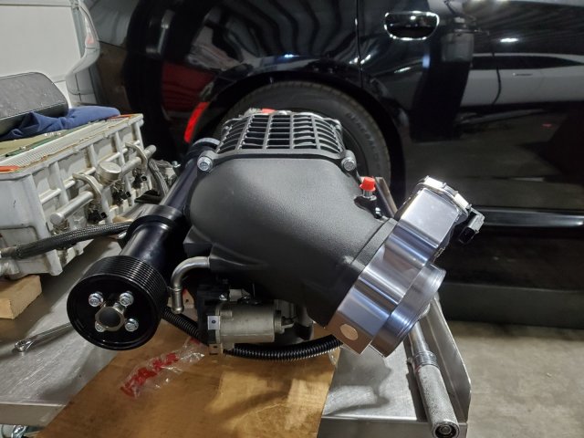

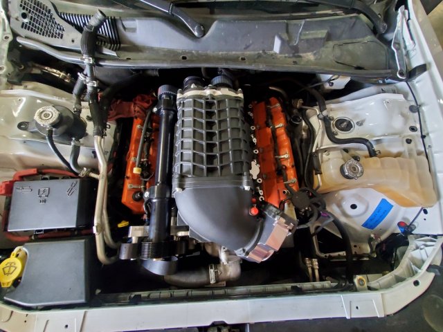

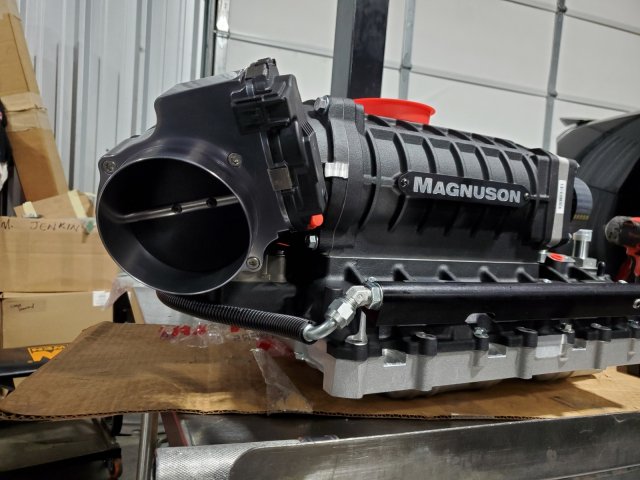

Making some progress on getting “Scarface” into the 9’s. 11011C1E-5347-47E8-9C0E-AF61E1233860.jpeg 3F73522D-1BD9-4481-9987-B8665508F5EC.jpeg 3F822174-AA37-4A45-AB7F-44A5C2158B90.jpeg

Thread Starter #44
CB30EAE5-7590-4117-A90B-2B99858CA4C1.jpeg ABA64F73-0EA5-489F-8161-737245E85727.jpeg

Getting closer BEB4A7EB-DA71-4F04-854A-9AF4039FE796.jpeg 45A7D8AC-D758-41A9-A7BA-3B18DBA81D35.jpeg 690DF7A4-2FDB-4A9E-9CF6-6A386572C9FC.jpeg

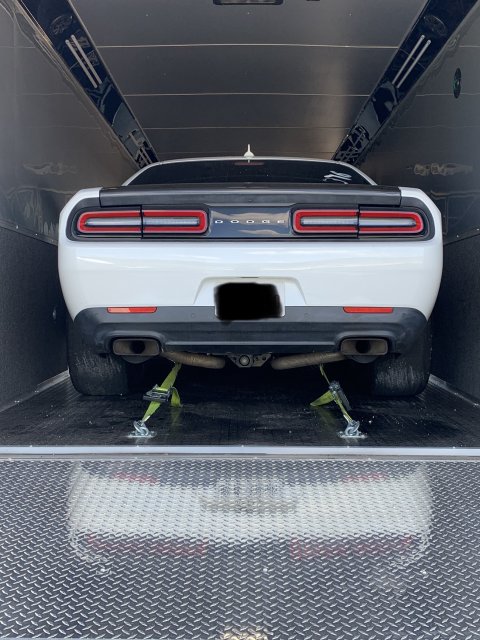

Thread Starter #57
Loaded and ready to head out to World Wide Technology Raceway in Madison, IL on friday to try and get some data and see what Scarface runs. FB86889F-43F1-4DDE-AD45-B7A3ED4C547B.jpeg

Thread Starter #59
Curious to see how that TB works. Good luck
I think it will be ok since I am only at 13lbs of boost currently. We ran it up to 6900rpm and it did not close shut. We will know for sure after the first burn out.
If I do have problems I will switch over to a cable TB and install the Holley Dominator ECU.

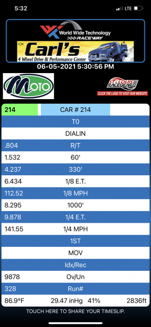

Made 4 passes this weekend on not so great track prep had to pedal it a little bit but did manage to set a PB. No issues with the VMP105mm TB, so will keep running it until we have problems. The FI interchiller was not cooling near as well as the last time out, so will check it for leaks and freon charge.
i am car 214
1st pass
2nd pass
4th pass
