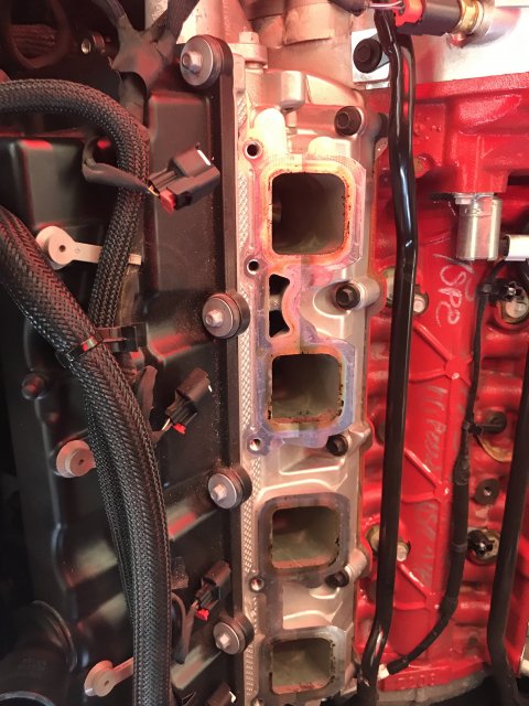

SC removed to install intercooler spacers
4,689
24,362
On the Redeye I did notice some oil blow by on the right hand bank from the poorly designed OEM gaskets.
I did not see any When we did the Hellcat.
See Redeye pictures below.

What gaskets do you use?

FI spacers have o-rings embedded, at all ports.
No need for gaskets.
Brilliant design!

Wow!!! the blow by on that thing was pretty bad.
