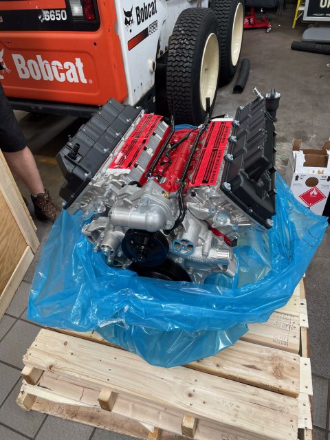

Strange. They told me the long block was in “national inventory”. Shipped and received in like three days. Maybe the Hellcat blocks are tougher to find? The SC was in Milwaukee.
Two weeks ago, received in Bloomington, MN. This one did not have the signatures and literature the original had on the top cover like the original Mexican unit had on it. It runs a bit more smooth, sounds different both front and back to my ear. Not as much whining, more raspy and louder exhaust. Very strange that it sounds different at all, but can’t say anything about performance until we can get a few laps in up north.

Hello all... I just recently purchased my frostbite 2021 Super Stock last month that I ordered March of 2021. I was taking a buddy for a ride in the car nothing crazy and he noticed a sound coming through the cabin. We got out opened the hood and he said I have a bearing going out he couldn't say which one. So with that I went to the dealership and sure as s@#@ rear main bearing spun. So now I am waiting for the approval for a new motor that will basically make the car worth squat. I don't know if its just me and what I have seen coming out of dodge but ever since the merger the cars are not holding together. My only real question would be on the replacement motor would they use a true super stock motor set up or the standard redeye? I guess you wouldn't really know for sure until a dyno pull then what. Sooooooo Pi$$ed
Sorry to hear about your bad luck. But, shit happens.
Redeye, Demon, SS and Jailbreak engines are the same.

Very clever🤣🤣🤣. Sorry guys I was MIA for a bit. Had some pressing family stuff back east. Anyway I did get the car back and have put a couple of k on the speedo. She seems to be running like she should. No issues to report. Dodge corp did end up giving me a free 100k warranty,covered my rental car, and the dealership hooked me up with some swag. Dodge reached out at least once a week during the repair process and was in direct contact with the dealership. The dealership was not used to that type of attention from corporate so things were tight and right. Thanks for everyone's support. Now its just a waiting game for direct connection to open up.
