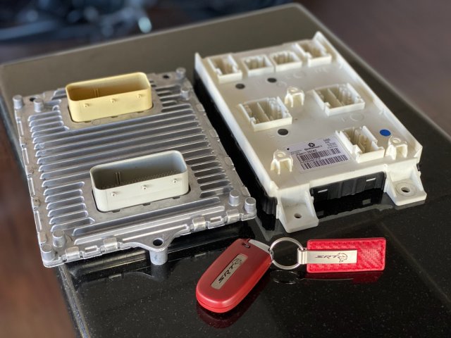

Passenger side kick panel. White plastic piece on the right 88AC5062-E9E4-4D54-941B-48D25E7305F5.jpeg

Computer ignorant. Why does this go through the BCM and not the ECM? I thought ECM (aka. PCM/ ECM) was engine, TCM was tranny, and BCM was body( lights, etc.)

Well... I don’t know either but I can say that it’s obviously not that simple. The reason I had that picture of the PCM and BCM out and sitting together is because they were being shipped to AJ for “reprogramming” so I could run the T400 trans. With a auto car..... when the trans is removed the TCM goes with it. All these additional devices communicate with the PCM and when one doesn’t phone home when requested, the PCM says no to everything. In the case of the transmission, that includes even starting the engine. So the BCM is a link in this circle and needs to be included. Hell... even the key fob had to be in on it. I don’t expect that AJ is going to be giving any tutorials on this subject here but maybe Speedy would find this stuff interesting enough to do a little research and enlighten us with one of his Garage talks.
Not really sure but I have drag mode suspension now and the bcm had to be programmed.
