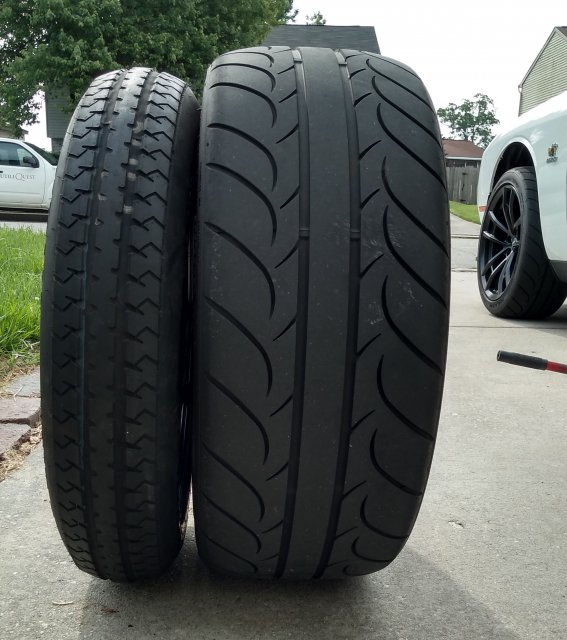

18x6 Racestars with 28" tall M/T radials are good for 150+MPH. This is one more reason I chose the heavier tires for my drag pack. HCs need something designed to fit over the front brakes. If I blow a rear tire I swap the front to rear and put the skinny up front. Easy peasy.

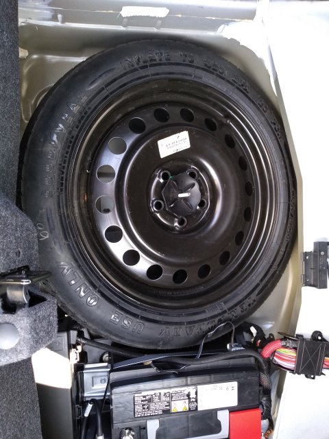

Can I please get an idea on how wide this tire / rim combo is at its widest? I’m looking for a spare that will both accommodate the HC’s large brakes as well as fit beneath the rear strut tower brace I just installed. Looks like Ive got about 8 inches:
Can you still access your tire well under the trunk carpeting? I took out that big piece of styrofoam and was able to mount it all there. The jack and all mount under the tire. There is a wingnut under the tire that holds the jack and handle down so it doesn't rattle around. Then there is that big flower looking hold down on top of the wheel that holds the wheel down (this is the stuff mounted in my car. I have also included some size comparison pics compared to my factory tire.

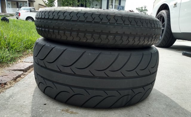

FYI - I was re-installing my drag wheel/tire setup on my REWB today. I had seen this thread earlier and decided to see if my 28" M/T front skinny would fit into my spare tire well. It comes close but just won't go. It might go if deflated.
Just info for the sake of info...

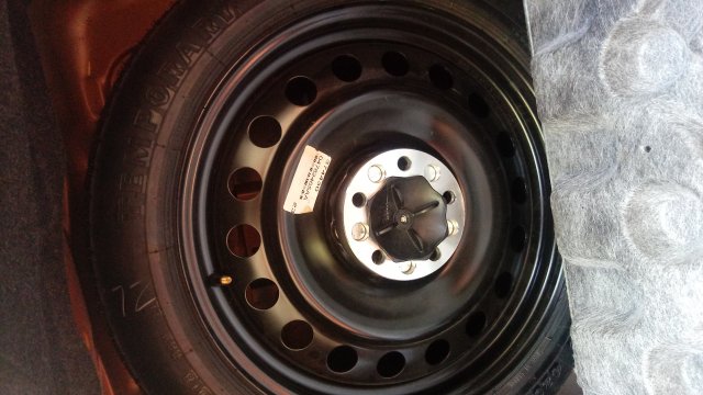

UPDATE:
Ok....I promised to report back after the "new" spare rim/tire arrived.
Weight = @35 lbs.
The good: it fits better than the original spare rim/tire that I purchased.
The bad: it won't fit without a spacer. I don't know why Chrysler lists this as fitting a Demon, Scat Pack 392, etc because it does not fit over my 4 piston brakes.
So...at this point I'm just gonna spend the 90 dollars for the spacer and be done with it.

I have 6mm worth of spacer on my fronts now for the R/T rims and tires that I put on for winter use. Those rims wouldn't fit over the front brakes either, but 6 mm just barely makes them clear. Either of the Dodge spares that I bought will require MORE than that 6mm. The original spare that I got from the 2007 300 needs more spacer than the 2015 Charger spare I just got this week.
The 2015 spare fits better than the 2007 spare, but will still need a spacer....and it will need to be more than 6 mm. With the 6mm spacers, the wheel hub will not sit down flat on the hub and I conveniently shaved off some red paint of my caliper when I was trying to see how much spacer I would need.
At least revlon red nail polish looks close enough to the color for the touchup ;)
I found the spacers above on that website after my original search started after one of the members told me what came in his SRT (2009) I think. This is supposedly the same spacer that comes in the Performance Spare kit (which supposedly Performance Spare also sells separately).

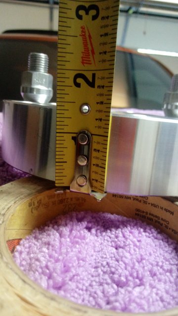

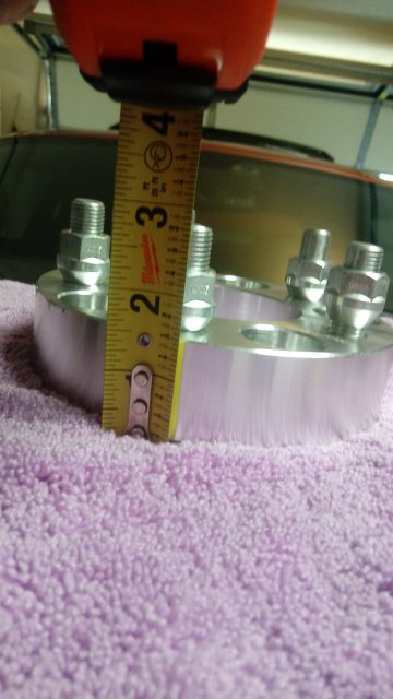

Ok...I found the info and pics from the other forum regarding the spare tire debacle.
This is what he told me about the spacer, and these are the pics he sent me. He has a 2011 SRT 392, and his car came from the factory with a spare and spacer to fit over the front 4 piston Brembos.
Many thanks to Roostking....not sure if he's on this forum or not.
"3 inches to the tip of the lug, Spacer itself is 1 3/8 inches thick "
This place sells similar spacers you just have to pick the correct thickness.
https://adaptitusa.com/dodgechallengermagnumchargersrtsparewheelspacer.aspx
