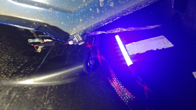

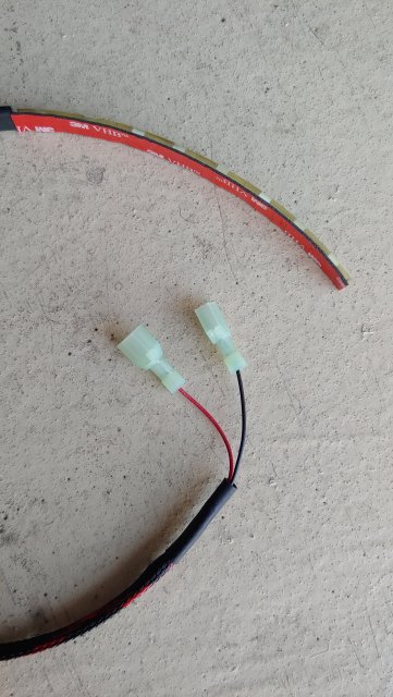

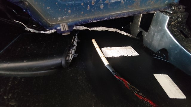

Got these in today. First of all, this is quality assembled kit. The leads are properly crimped, the connection point with the LED strip is sealed and heat shrinked (see Pic 1 & 2). Cable has snake skin on it for the entire run up until a small whip for the leads (see pic 3). Also included was a diagram for both driver and passenger side cable pinout for which to tap these into using the supplied taps.

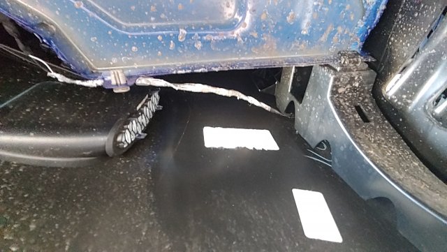

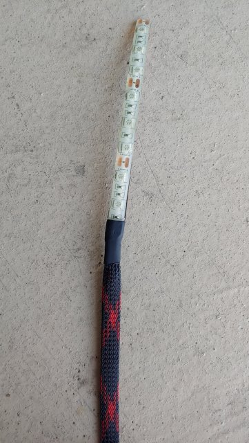

Being that I live in Florida wanted to mount the whole thing in such a way that water would not be an issue. Both ends of the LED strip are sealed but can never be too careful. The area where this would go is open enough to not have to remove any body panels or anything to get to where you want to go. Just drop down and scoot underneath the rear quarter panel by the bumper. After looking at it for a minute I decided to mount the strip vertically just past the vent, so that it would be parallel with the vent as seen from the back and light up the little inner quarter panel space (see pic 4 & 5).
At this point I was going to tap into the side marker lights as indicated by the paperwork. Mine is a 2020 Scat Pack Charger. On the driver side there was a small bundle of 2x wires that were easily identified as the leads for the sidemarker light. On the passenger side there was a larger bundle seemingly as this is where the majority of the harness comes through the body paneling. Both leads were wrapped in protective shielding.

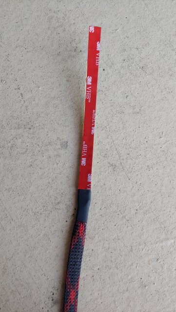

Peeled the shielding back carefully, wiggled the wires open enough to get the taps on there. Closed them up, connected the leads from the installed LED's and on they were! At that point in time I zip-tied the LED cable to the car's harness to provide some strain relief on the leads and then also zip-tied the LED cable to the frame to provide some strain relief on the adhesive tape (see pic 6). Made sure that there was a belly in both for drainage and went inside to have a beer!
**One more tip that I would offer to others. Depending on the age of your car and many other factors the car's wires can be very hard to puncture fully by the taps. I noticed that on mine they were gripping but had a hard time making a clean cut to the wire. VERY carefully I backed away some of the insulation of the wires with a knife to make sure that the taps got a good bite.**
Thank you very much to @Diboblo for a great product and making it super simple!! Now on to some pics.
