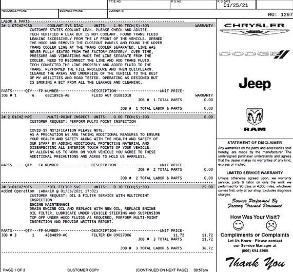

Thread Starter #27
So I decided to have a new tire ordered and installed while it's at the dealer anyway (picked up a nail a few weeks ago) so no pics because it's sitting there waiting for the tire to come in. I did get an invoice that describes it as an upper cooler line below one of the plastic access panels that hadn't been seated correctly from the factory. Here's the slip. Had them do my 6 month oil change as well. Should be pretty easy to pop those panels off and have a look if anyone wants to double check theirs.

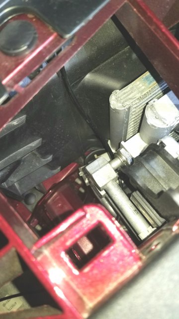

House of power
2,287
5,366
Thread Starter #36
I’m assuming so, yes. When I picked up my car they had it buttoned up and I never got pics of the line from them. But from their description that would be it. Just was never fully seated and tightened correctly.
