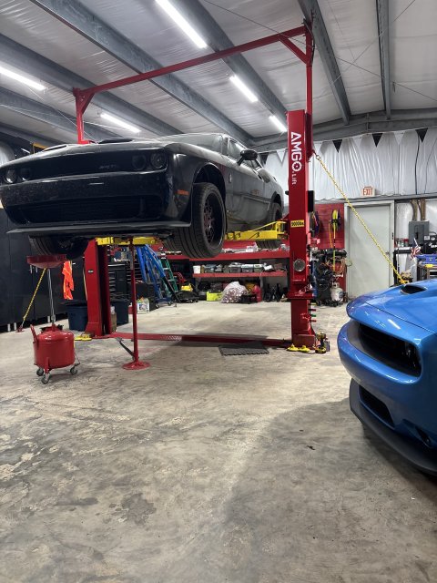

I bought and installed an Amgo 9K lift for $2989 tax and delivered to a hub close by where I picked it up since a trailer wouldn't be able to get in and out of my place. Set up was fairly easy. I used an engine hoist and straps to lift the columns, had some help on the ladder work from a friend and the extra precautions I got talked into (chained to the floor, overhead brace) but better safe than sorry. That lift isn't going anywhere. Wiring wasn't complicated at all if you can read instructions. If my old handicapped as$$ can do it @Speedy! can surely do it. The best 3G I spent in my life.

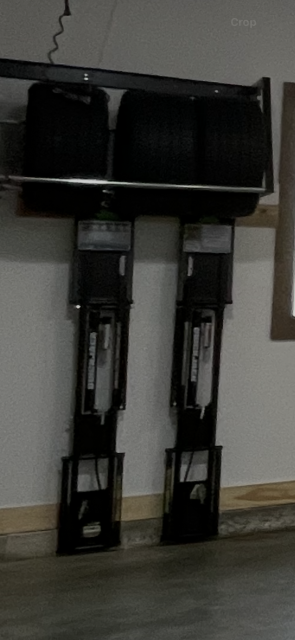

I recommend the hangers. You want to be in good shape and use good technique to lift them up onto the hooks. ;)

Very nice ..(and safe)...but what's the excuse for the filthy car...[bath][dunno]

I know, I know it's on the list!!

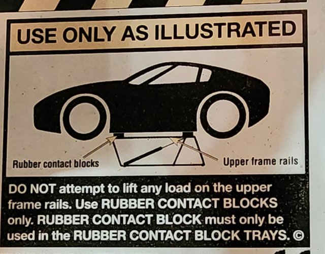

If you go through the various pictures that people have posted, the main legs are either tilted "forward" (pointing at engine), or tilted "backwards" (pointed towards the trunk).
I use my (usually) tilted backwards, which is wrong according to this....
See how the main legs are tilted "forward"...
"USE ONLY AS ILLUSTRATED"
Oops...
