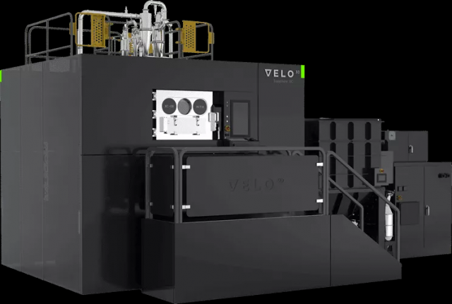

We're going to a trade show on Thursday, we're supposed to be looking at yet another new machine on the market that will help make production more viable.

Whoa, serious equiptment
Delorean Time machine ain’t got nothing on you.

Another million dollar machine?

$5M initial, one machine, 5-10 required...
I don't have the beach balls for that and that kind of money. GL.

Is this for making brake pads??

That is a DMLS printer, what you make in it is up to you, for us, we are printing our rotors in a similar machine, but are strongly considering this one, because reasons....

DMLS is a somewhat generic term in the AM industry, "Direct Metal Laser Sintering"
