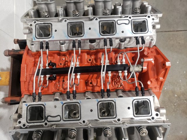

I haven't posted in a while but thought I'd chime in. I suspect we have put as much N2O through these engines as anyone out there. We have two shop Hellcats that we spray. One consumes a 35lb bottle (15lb of N2O) every 2-3 1/4 mile passes. The other is our street Hellcat with the original factory engine and I am guessing in the area of a 150hp shot. If I can give any advice to the OP is do not try to spray even a 50 shot without pulling at least a small amount of timing or adding race fuel. If you are not going to modify the tune then adding race fuel is the only safe option. These engines love N2O but timing and fueling is critical. Also the installation must be done properly to insure that there is NEVER N2O sprayed with the throttle blade in any position other than WOT.
Our street Hellcat with the original factory engine has more bottles than I can count run through it over the last 5 years. With proper tuning and fueling I expect quite a few more will be emptied as well :)
Just be cautious regardless of which path you choose.
Some eye candy.... Two stage dry system we run on our big tire Hellcat that Micah designed:

I haven't posted in a while but thought I'd chime in. I suspect we have put as much N2O through these engines as anyone out there. We have two shop Hellcats that we spray. One consumes a 35lb bottle (15lb of N2O) every 2-3 1/4 mile passes and the other is our street Hellcat with the factory engine and I am guessing in the area of a 150hp shot. If I can give any advise to the OP is do not try to spray even a 50 shot without pulling at least a small amount of timing or adding race fuel. If you are not going to modify the tune then adding race fuel is the only safe option. These engines love N2O but timing and fueling is critical. Also the installation must be done properly to insure that there is NEVER N2O sprayed with the throttle blade in any position other than WOT.
Nice.... and thanks for the input. Real world is what I'm after.

Thanks! Micah does awesome work and the system works flawlessly. 1st stage hits when I release the brake and the second stage is coming in about .4 later. So far, with the smaller jets the car is hooking well but it does have plenty of tire :)
