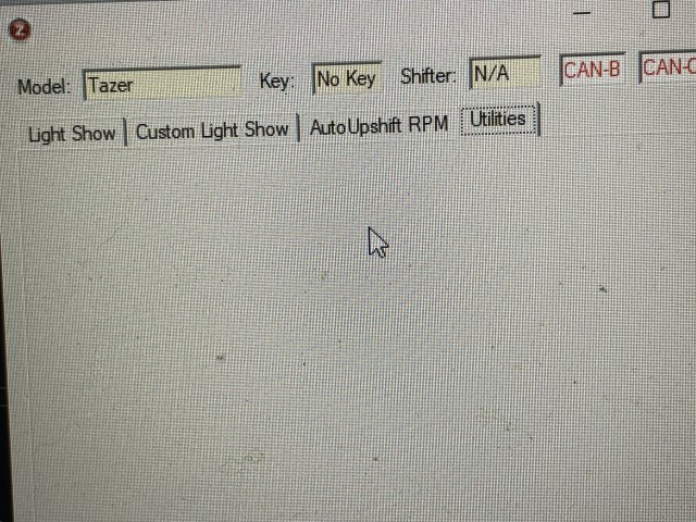

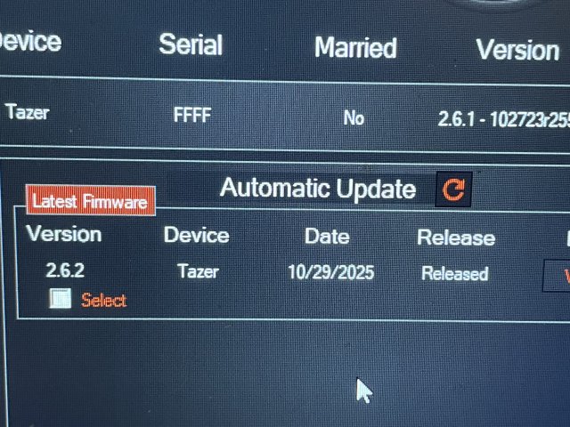

the first pic shows it's unmarried the second show no key I thought for the tazer to work you had to have a key to match the tazer.I'm not sure on that......thats the biggest problem I'm not sure of anything. Module Expert will take the bcm and check it out and if it's faulty they repair and use my Vin# to program the bcm

well a guy told me try it on my M6 hellcat which I dont know why I didnt think of that.....and the tazer work fine on the M6 popped up on the evic screen instantly. So it must be the bcm I did install triple pump about 2 week ago and ran the wire's where the star connector is at but was careful no to pull on any other wire's.
