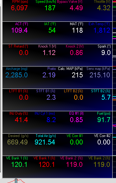

Here is a quick hit last night . Unfortunately my bypass valve opened for some reason so I have to figure that out .

More tuning . This time on pump gas

It's definitely gulping in some air. The aircharge is more than I've seen on a Demon with a Whipple.
When I select parts I put a lot of though in to each and every part. It took me a long time to come up with a cam profile. Some times I win and some times I don't. I`m working for maximum efficiency. .
11,025
Thread Starter #1,955

2.19 pratio is a lot of air. ~17 lbs of boost. If the fuel tables on the VE side were causing it to run lean maybe thats why they opened was my initial thought but you are .85 lambda so you have plenty of fuel.

I'm tuning with VE only now . I turned ANN off . With the new camshaft and it being locked it was causing me all kids of issues . I could never fine tune my car . The manufacturer uses ANN because of VVT . In ANN there is many VE tables because of the cam moving around . I believe the hellcat platform has atleast 5 VE tables that I heard of plus other factors . And all off them we can't see .
So I turned off ANN and started using VE only and the car is running fantastic now as you can tell from my aircharge. I have to do 5th gear pulls "in Mexico" to get decent data logs because the blows the tires off in 4th up to 5500 rpms . It get a bit scary at those speeds .
I also replaced my 274 fuel pumps with 285 pumps . . With FIC 1440 injectors and (2) 285 pumps I have all the fuel I need for my car even on E95. ( remember street car not race car)
Also think about this for a minute...... I have a 2.7L supercharger that is ported and a 105mm throttle body wit a 10% lower and a 3.17 upper and my Pratio is 2.19 ( 17 psi of boost) . My "boost pressure " is lower then normal but my aircharge is up substantially . That shows I am making the engine more efficient .
On another note my car is less prone to "false knock " it seems then with the factory demon cam and ANN turned on. I left my spark tables alone from before and I'm slow creeping up on the timing 1/2 degree at a time and so far it's liking the extra timing . Even with 2285 aircharge!
I'm tuning on straight pump gas at the moment and I usually run conservative .
