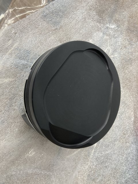

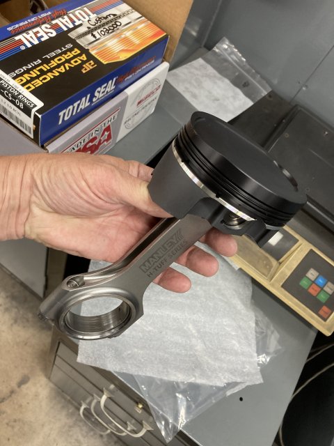

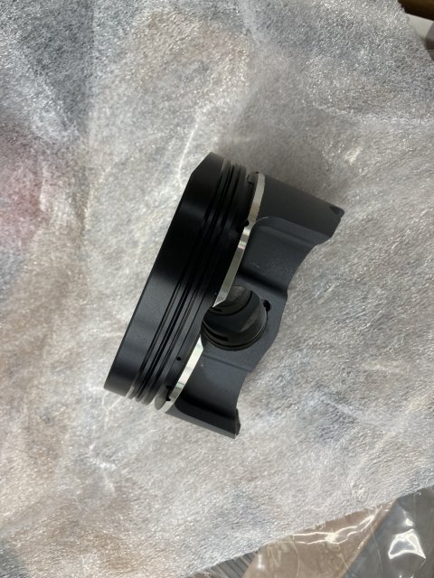

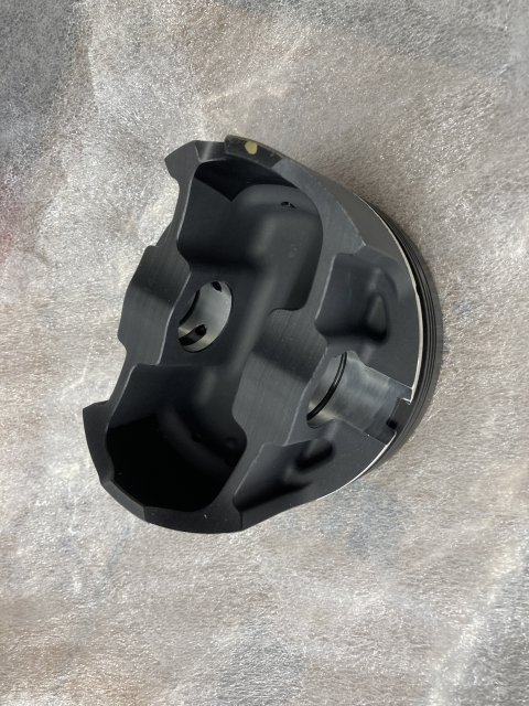

Piston kit finally arrived, look at these babies

Nice ! Very nice . Looking forward to the assembly.
7,068
18,343
Dang that top ring land is serious! Now start a build thread LOL
