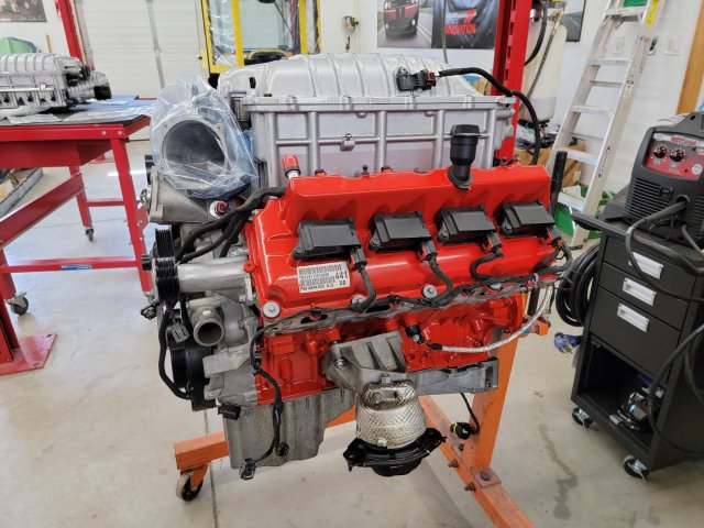

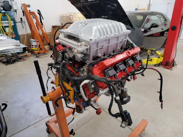

I forgot to take a pic of the engine with the wiring harness all clipped on( it was a late night) . @DemonSRT could you post a current pic of the engine . . Thanks
DemonSRT
#1457
561
1,764
Kawartha Lakes
NO! Your disturbing my ugly sleep!
Just kidding.:ROFLMAO:

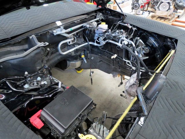

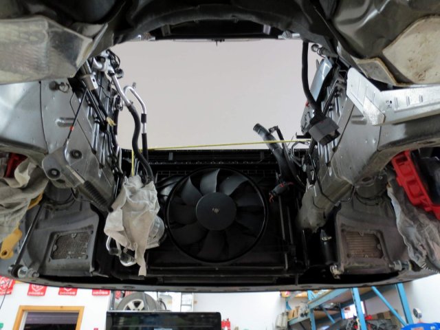

Good that you guys found those little push in clips for the harness. Those are hard to come by.
Going out the bottom on the cradle is WAY easier, but I think you have to disconnect the A/C lines on the Hellcat to clear?
DemonSRT
#1457
561
1,764
Kawartha Lakes
Hope that James doesn't mind me answering this on the A/C lines but no you do not need to disconnect them at all and that way you are able to keep the system charged.
You just need to bring the car up slowly and move the engine/trans assembly back as your bringing up the car which is why you need casters on the cradle instead of just a table. These 2 pictures will show that the compressor is still on the lines supported up.
17,662
55,239
Hope that James doesn't mind me answering this on the A/C lines but no you do not need to disconnect them at all.
View attachment 41017 View attachment 41018
