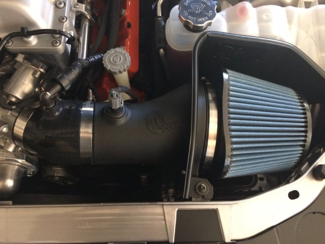

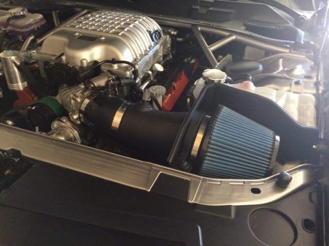

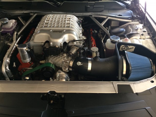

These intakes are a great supporting mods . If you are looking for huge gains this ain't it . I'm sorry but after a certain point the stock air box will not flow enough volume. That "point" will 'be different for everyone.
at least it will look good
I agree , at stock boost a cai is not going to do a lot until you turn it up, I don't want to turn up the boost , but a open box cai does sound & look good ! I think the AFe looks similar to the RE but without the ram air hood.

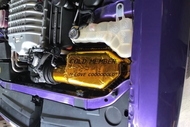

Don't forget my idea for the gold intake. :ROFLMAO::ROFLMAO::ROFLMAO:
