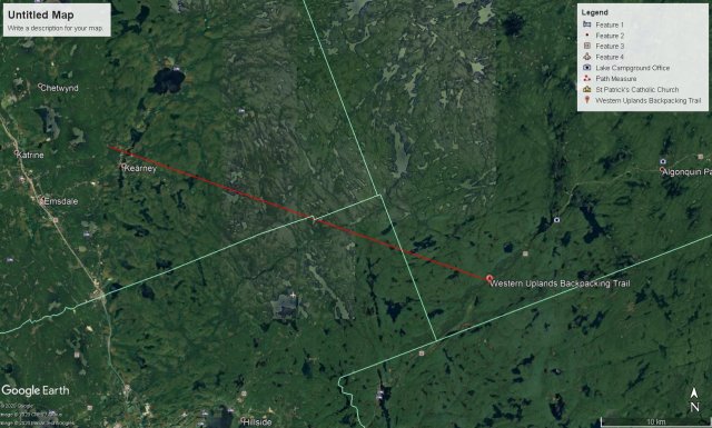

Western uplands trail in Algonquin park
Nice if you walked 25 kms in a straight line you would have been at my cottage. Next time take the town of Kearney Algonquin park access not the hwy 60 access. Less people and the terrain and views get even better. There are three access points called the Tim Lake, Magnatawan lake and Rain lake access points.
11,025
Thread Starter #1,508
I use those access point all the time on my canoe trips for the very reason you mentioned .
