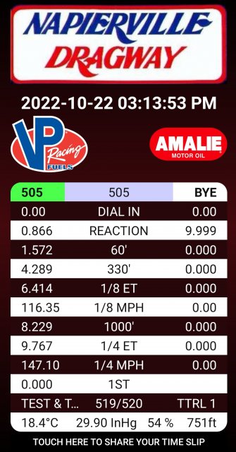

I guess 9.7@147 is not bad for a broken car....... lol

I can't read the time slip, all blurry/small. What's it say?
Here you go Screenshot_20221023_135701_com.dynogeek.racingslips_edit_1509742665223270.jpg
