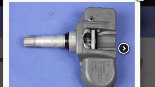

Here’s a picture of one, see how their clipped together? I had a new one come apart in my hand installing it. I’ll have a new one in hand in a few days, tired will be here next week as well
3,808
9,019
Thread Starter #30
Another pic of back side, sensor just slides onto that flat clip, held in place by rim once installed
I just installed 6 of these and they do not just clip together. So, I have no idea what you are talking about. Please, be sure and show us pics when you get the tire dismounted.
