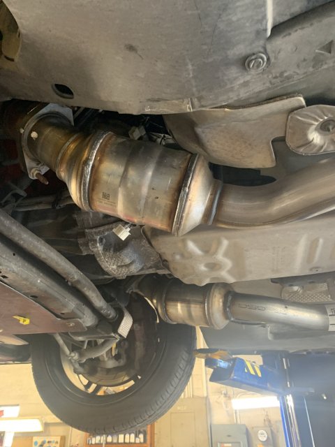

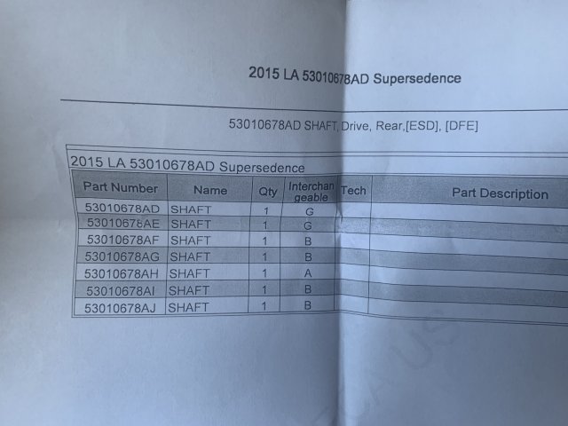

Went to the shop today, recall work was done. Brand new cats, O2 sensors and a PCM flash. Wonder what it will entail. Will compart logs after I get her back. Spoke with service manager and we talked about the drive shafts being a weak link. He explained he agrees 100%, he said there have been seven revisions since they were produced. He printed out the interchange sheets and showed me AA through AJ. Thats crazy!
Drive shaft wont come in till Monday. Delays are temporary, improvements are permanent (or until it breaks again lol).

Me too, the cats from the fix appear to be bigger, we’ll see. Also going to hit up a dyno as well. Was around 640 at the wheels prior to this change. Maybe even lost power from the driveshaft (debateable tho)

The cats do look a little bigger in the pics or its a allusion from the pic ?
