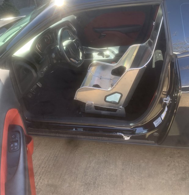

I have a lot of weight removed, airbag system is still active. If you’re competing, then you have money for a cage and don’t care about welding a cage in your car. If you’re doing test and tunes or “private” competitions, up to tech but don’t run an 8 and you’re fine.
