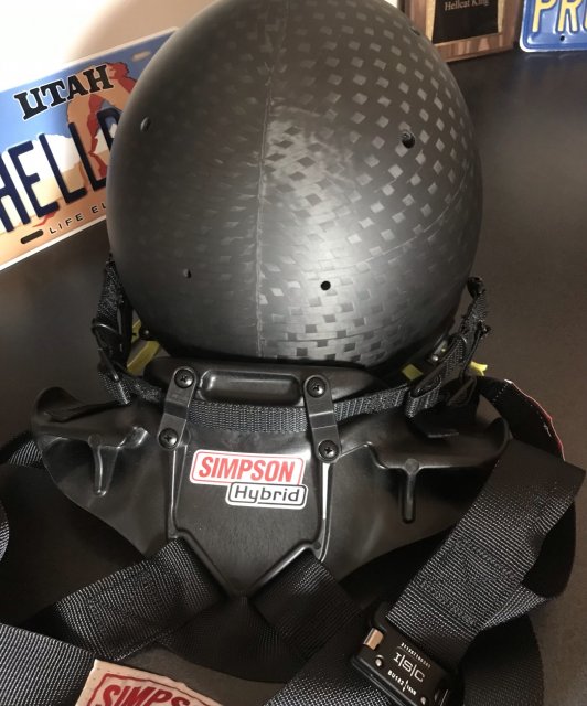

Kinda weird that they even bothered with the et part of that. 150 mph pretty much covers the concern and a car running 150 isn’t even close to a 7.49. The chute requirement doesn’t have any et attached so…. 🫤. I use one of the Simpson Hybrids and it does a excellent job of controlling helmet movement without banging into the helmet like the Hans. Another factor in protecting you neck is the weight of the helmet. Get the lightest one you can afford. A9743EED-4C6A-4B8C-96B4-56260C24465B.jpeg

This should open up the discussion into the Hans device. Who has experience with them. Kind of along the lines if what Marc said, are they all created equal? what should we be looking for when purchasing them?

I’ve used the Hans for some time. I switched to the Simpson for a couple reasons. If you look at the Hans, it sticks up behind the helmet with tethers that are higher than the Simpson. My helmet was always banging up against the device and it was annoying. I was always aware that it was there. Also some reports that the top part of the Hans can get hung up on anything overhead when trying to get out in the event of a crash/fire. The Simpson does a better job of limiting the movement of the helmet in all directions than the Hans and the strap on design is more comfortable when on.

I've used only HANS, starting with the original design, and currently have a newer, lighter version. Took a little getting used to at first, especially competing in a "finish line driving" class. The original version definitely limited the ability to turn your head, the newer versions greatly improved that with the ability to slide a little. I personally would never race a fast car without it or a similar device. In the interest of fair reporting, the NHRA often yields a heavy hand in rulemaking, with some things challenging logic and sound reasoning, but this is one area I will never complain about, even though it adds more cost to racing. These things have saved numerous lives from basal skull fracture.

Another thing to be aware of…. If you are running in the 8’s or above 150 mph and have to get thru the NHRA tech inspection that is required at that level…. you will also need to have either a SFI hood or Donut in addition to the helmet restraint. Currently a donut doesn’t require a hood but a device does. The reason is fire. The device doesn’t keep it from getting at your neck and face. The SFI donut is considered fire protection as it closes off the bottom of the helmet. This is one of the things I have had them check every time. When the check my device they always ask to see my hood or donut.

But is it as effective at controlling movement at impact speeds? Not saying its not, just asking.
