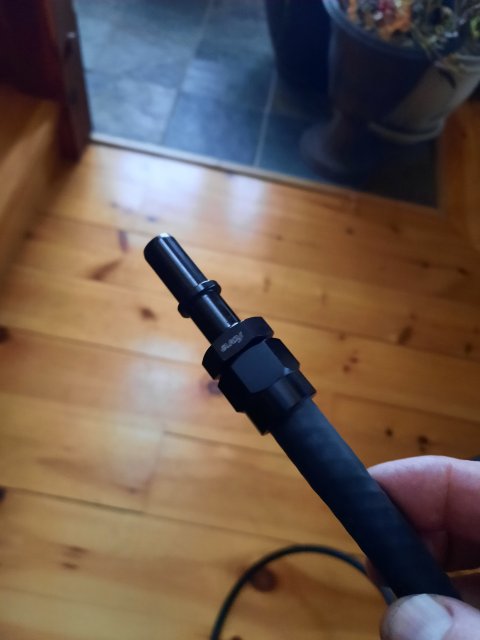

The tank design on these cars aren't my favorite. I can't even drain the whole tank through the fuel tank. The 2 part saddle or whatever it is is frustrating. I think a better design could have been done.
the restrictor fitting / kit that OST sells works great an allows the fuel pump to pump both sides empty. car won`t start until fuel is added........... it works that good.

I can`t find it now as well but that`s were I bought it. there`s not much to it. maybe call or send them an email. it`s 2 year`s ago I bought it from them.
will take a pic an post.

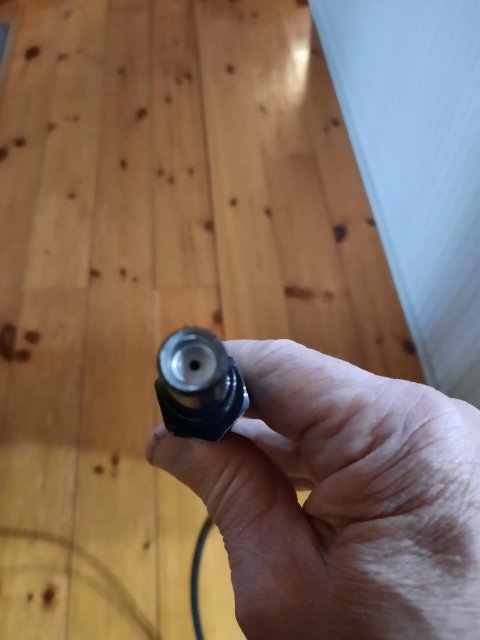

this thing is so simple an works so well.
so the way it works............. the 1/16 inch hole is a restriction causing pressure in the fuel line as well as slow the flow which causes the pump to pull from both tank saddles till empty.
without that tiny hole the pump will cavitate quick an will not pull fuel from opposite side.
all it is, a fuel line fitting with small automotive frost plug shoved in the end an then drill a 1/16 hole. the fitting is made by fore. attach hose of your choice on the end.
the key to it is that restriction.

the rib on that fore fitting is thicker than factory steel fitting making it harder to install an remove lock clip so I suggest a oem fitting off a car at the wreckers an make your own.
OK, so this fitting goes at the fuel line connection at the fuel rails ?
Wonder if this would put too much pressure on the F pump ?
not at all, just enough to make it work. I have a hoist an I find it easier to do the disconnect at the frt of the tank, I find at the fuel rail to be a pain.

And we are talking about this working for the stock hellcat fuel pump ?
I still have a stock pump with a JMS booster.
under normal driving your pump is under far more stress from higher pressure.
this would work on yours for sure.
