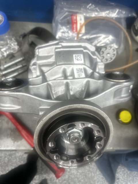

Looks nice. Think it even needs a brace?
Do they sell them complete with gears and all setup?

Yes they do

Wave track makes a carrier that’s what I put in
Ok, pretend I know zero about these rear diffs-which I don’t lol. What all is needed to put into one of these, and where do you source the parts from?
Hhp sells the carrier if you have a 3:09 diff now you can transfer the ring and pinon. And tba sells the cases seals and shims as a kit or you can buy a full rear end done from them

Just looked, you can only order the hellcat wavetrack through dusterhoff? That’s dumb
Yeah, I have a 3.70 now, need a 3.09. So need a ZF for parts still it looks like
TBA also has the wave trac in stock. TBA also has the seals shims vise holder and carrier bearing holders Easier for setting it up!

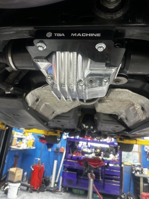

new diff is I. Sexy looking. Thanks Todd

This thing is purdy looking, kinda Jelly but I got some goodies on the way so I can't complain :)
