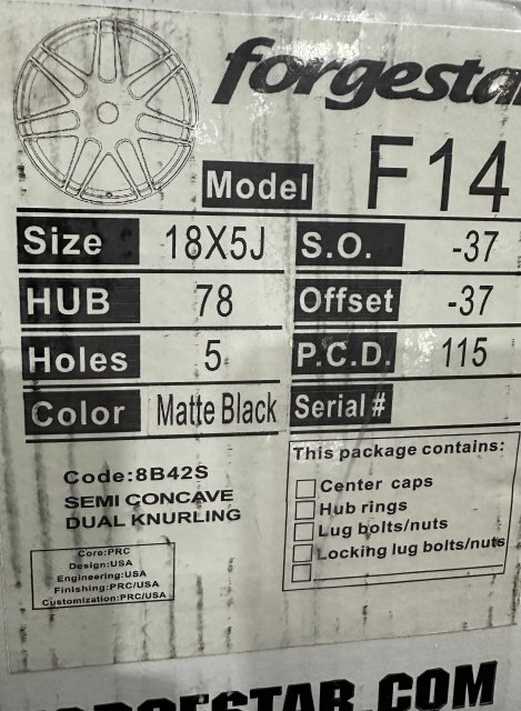

@2ndAmend yiuve seen my setup right? I have the 18x5” forgestar f14s on the front and 17x10 beadlocks on the rear. I love em, look close to stock. I think they have a version that clears the calipers of the newer redeyes now
8,745
7,679
These will NOT clear your calipers without a small spacer, which in my opinion is fine. I have 1/4” spacers I’m not using if you need them. They clear mine no problem though because I have the older style 6 piston calipers. Just took a pic of my box for you

I would call up dragracinwheels.com or message them on the forum, even just to get info. They get back to you right away. And Weld owns Forgestar - when you call, you have to choose weld or Forgestar since they’re under the same umbrella now. I’ve called weld for torque specs in the beadlock ring hardware

Measure on your forgestar as well with calipers, please. I had special rings made, were $100 for a set of 4. Look at what the hub says on my box. That’s not the hellcat hub size. They 100% do not sit on the hub.

I used US wheel adapters. They had the forgestar wheels in their system already so knew the size, found the email.
