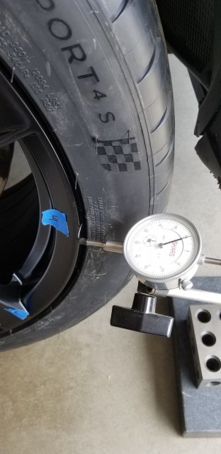

I did this for different reasons, but if you wanted to rule out the wheels, get an indicator on them an log some numbers.
Then compare worst with nominal.

You could have them break the bead and spin the tire and rebalance the worst one until it is better. Start half a turn then a 1/4 if it is still not good
I’ve done this often. Indicate the rim, indicate the tire, move the high spot on the tire to the low spot on the rim. Once this done then index the tire/rim combo around on the studs and find the index that has the least run out on the tires center thread area. Then mark the stud to the hole in the rim. I use 4 different color paint markers so I know which rim goes with which location. Sounds extreme but it produces fruits. I run at high speeds often, 150+ most runs 180+ at times. I don’t do this unless i have a vibration issue that multiple re-balancing hasn’t solved. It works.
That is what a Hunter Road Force machine does, if asked to.
I like your idea, but trust the machine more as it also takes into account the softer sections of the sidewalls, and balances accordingly.

I’d rather the machine do it!! Tough part is finding a operator that knows how to do it, let alone be good at it and know what their doing to where you feel like you can rest assured any vibration afterwards it’s not the wheel and tire. Hell, I have a hard enough time getting them to understand why I want them after the final balance spin to just loosen the hub lock and rotate the wheel and then spin it one more time for me, to which it should show balanced every time if it was on center and done correctly the first time around correct?
