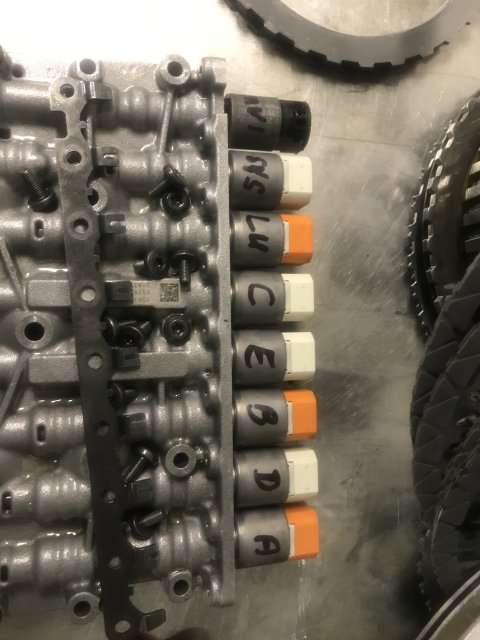

Here’s a pic of the solenoid set up and identity of each solenoid there is a green solenoid on the valve body that is for park function only, I’m shipping the solenoids out today to my friend Noah at Ericsson industries to have the solenoids flow tested , this will be critical as I have found out the solenoids are NOT available separately, you would have to buy the Valvebody from Chrysler at a cost of around 2,000 I will know next week how they tested and of course I have my fingers crossed that they pass with flying colors 7B975174-E70B-4312-AE11-8C0E3DBC4649.jpeg

I covered this in another thread (think it was when Speedy caused his engine overrev) people fail to recognize that this a hydraulic pump and it's abilities and limitations are dictated by the physics of that system; including the acceleration rate. You can influence it's behavior with mechanical changes, but even then it is only within the limits of the electronics.
This is why folks are going to proven analogue slush boxes when the thresholds are exceeded.

That wouldn’t explain how mike @ostdyno is spinning them up to 7500 rpm
