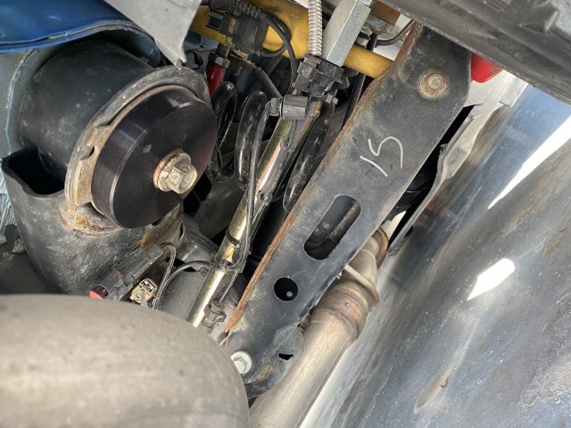

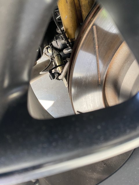

I can give you a street review. I noticed almost no change with the cradle lockout on the street. Arms stiffened up the rear quite a bit, but doesn’t bother me at all. I daily drive the car. Big plus is setting camber closer to zero for the rear tires.
Just locked out the cradle and put Nigel’s toe arms on.
