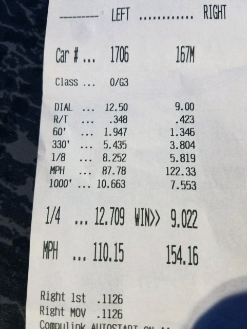

THANKS@MEANCAT ,IM PRETTY POSITIVE ALL SHOULD GO WELL BUT UNTIL I GET IT STARTED AND DRIVE IT I WONT ACTUALLY KNOW ,FROM WHAT IM HEARING FROM CURT THE TRANS ARE HAVING ISSUES GETTING THEM TO SHIFT AFTER REBUILD SOMETIMES ,I PERSONALLY BELIEV THAT IT PROBABLY LIES SOMEWHERE IN THE VALVEBODY OR SOLENOIDS ,THE THING THAT CONCERNS ME ON MINE IS THE CLUTCH PACK CLEARANCE , I KMOW I HAVE THEM SET TO FACTORY SPECS BUT WITH THE ADDED CLUTCHES THE CONCERN IS THE RELEASE OF THE PACK WHEN ANOTHER IS COMMANDED ON BECAUSE OF THE POSSIBLY OF THE CLUTCHES DRAGGING ,MY UNDERSTANDING OF THE WAY THE SHIFTING IS CONTROLLED THE COMPUTER SHOULD BE ABLE TO ADJUST FOR IT ,BUT IF I DO HAVE A CONCERN ILL HAVE TO PULL IT OUT AND THEN I WILL ADJUST THE CLEARANCE FOR THE ADDED CLUTCHES ,I THINK IF IT HAS A PROBLEM WITH THE CLEARANCE IT WILL SHOW UP AT WOT BECAUSE THAT WILL BE WHEN THE THE PROCESS OF ONE RELEASING AND THE OTHER APPLYING WILL BE THE FASTEST SHIFT

solenoids came in today ,I reset the adapts after the valvebody install and drove it around in street mode to let it adapt ,easy driving , after 5 drives thru 8th I did some drives in sport mode then in track trans performed beautifully ,I just did a wot pull in track mode for the 3-4 shift with my 2.65 set up and it shifted right on thru at 6435 rpm :), my initial impression is the shifts are very nice definitely better then before nice crisp shifts in sport and good banging shifts in track ,street also feels a little more crisp from before
