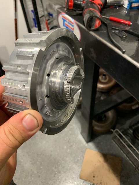

APARENTYLY THESE TRANSMISSIONS HAVE FAILED MORE OFTEN THEN WE HINK BECAUSE SINCE I STARTED ON MINE I HAVE FOUND SEVERAL WHO ARE ON 2ND OR 3RD THRANSMISSIONS IN THEIR CARS AND IT SEEMS TO BE THE HIGH HORSPOWER ONES ,ID LIKE TO KNOW IF ANYONE HERE HAS EXPERIENCE THE BREAKAGE OF THE OUTPUT SHAFT AND IF SO DID IT REAK ON THE LAUNCH OR ON THE SHIFT ?? IVE HEARD ABOUT THIS HAPPENING
My car wheelhop on launch

My car lots of runs last year 930 rwtq
Holy crap snapping the output shaft and breaking the e clutch damn
When you have wheel hop and the tires grip and let go and grip again the shock travels right up the gear train
We see that same stuff happen on tje Deisel trucks where they spin the tires and then get traction wipes out output shafts and reaks havoc throughout the entire assembly
