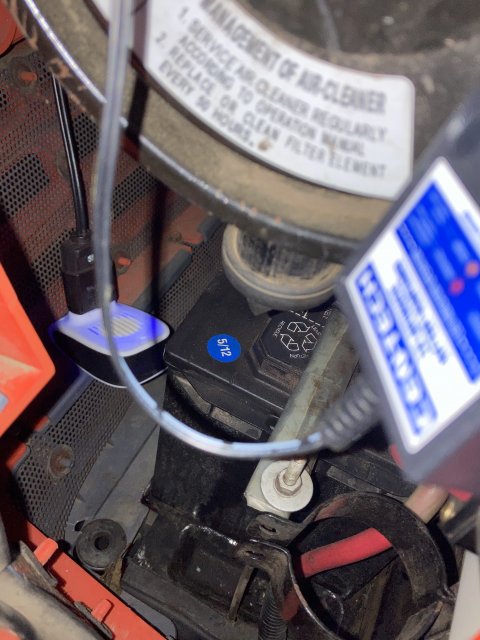

I agree with most of the above. I would also recommend throwing your battery tender in the trash and getting another brand. I have been using the HF cheap crap on my cars, tractor and Bobcat and everything has been working perfectly. The tractor battery still has its 5/12 sticker on it.
The HF trickle charger I used many years ago failed and ruined the battery. Used "Battery Tenders" since, 4 or 5 of them on different vehicles without any issues.
