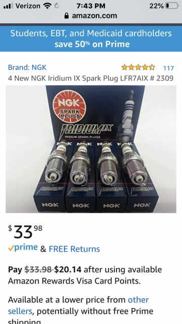

Try stock NGK plug gapped at .026”
3,345
7,919
These

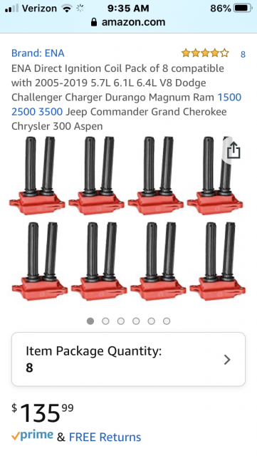

These coil packs are made by MSD for this company, I have a buddy running them along with the NGK plugs gapped at .024” and they took just took care of his miss in the big end. 712E6C85-43D8-47F6-BFB5-E7A6636EBE14.png
