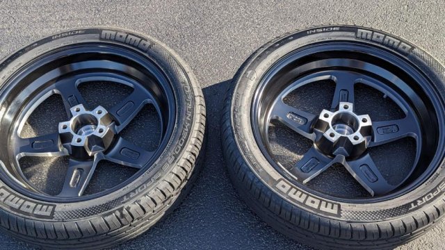

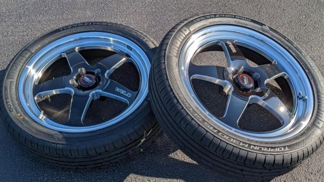

They make skinnies for your years. I have a pair on deck if you are interested with tires.

I thought they didn't make skinnies for the '21 up cars with the bigger brakes?
3,553
8,654
