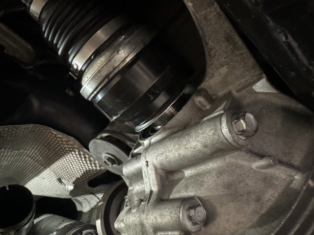

Can’t believe this thread made it to 99 pages. I am happy to say that the car is retired. This is how fucking much this car hates me.
Axle is toast while trying to get it in then on the driver side, the diff would not seat the other axle.
had a little bit of a mental breakdown and just asked my friends to help me out.
more axles, same diff (2.62) and she now drives under her own power.

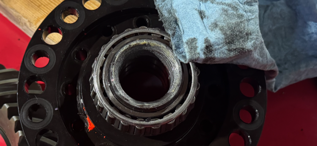

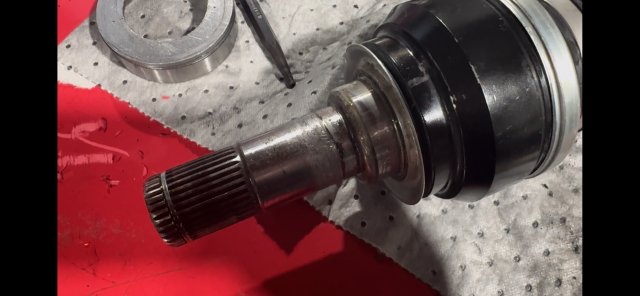

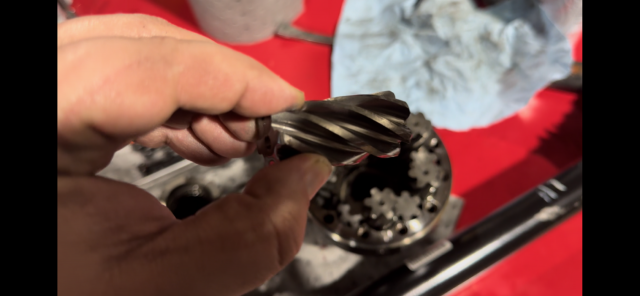

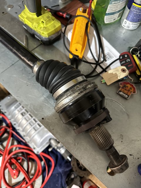

Final post I'll make to this thread. Wavetrac update:
The carrier has been sitting for a few months, I would literally look at it and curse it and just stare at it and walk away. Finally said I need to make room and took it over to Starcks performance as I would need a press to get it out of the carrier. Disassembled the carrier, none of the wavetrac gears or internal components are at fault. The demon axle somehow shredded itself in the carrier then welded itself to the carrier as that's why I couldn't get it out.
it will be shipped out to wavetrac for repairs or placed in the graveyard of 3.09 parts, all based on what HHP or Wavetrac want to help me with.
View attachment 125703 View attachment 125704 View attachment 125709
That’s insane. Any splines twisted?
Also just so everyone is aware, this is what killed the Hellcat at the track. Zero support from HHP, zero support from Wavetrac and zero support from Dusterhoff. One hit and boom = shit products.

Wow i somehow missed this post. id be interested to see if either the axle or bearing tolerance were off on either. the splines look good. very odd spot to get seized in the bearing like that? possibly a small piece of debris or something got between them and got it hot enough to lock in there like that.

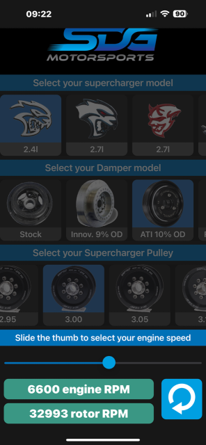

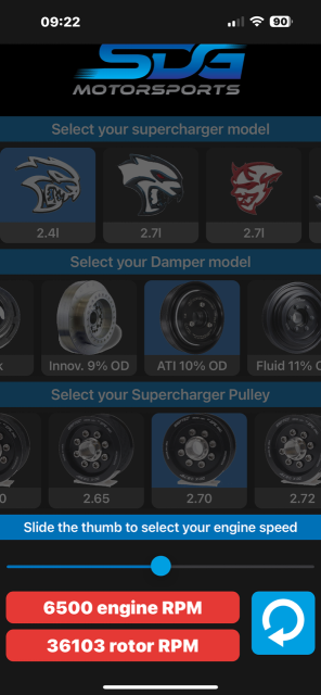

So make it make sense. Last time the car was on the dyno it had 2.70 upper and 10% lower. With this, the car always felt loose, ready to just be a rocketship.
Last night the car was on the dyno as we were trying to slow it down. Went with a 3.0 upper and 10% lower.
Car felt like a freight train but solid, didn’t feel loose but felt deadly.
Now if we use SDG’s tool it does not like the 2.7/10% combo. However it does like the 3.0/10% combo.
Its as if removing the heat from the blower negates the psi from having it.
8,663
7,636
Wow, I had no idea that tool existed. So the less is more theory here
8,663
7,636
Wow, this tool is amazing. Now I know how much I can pulley down

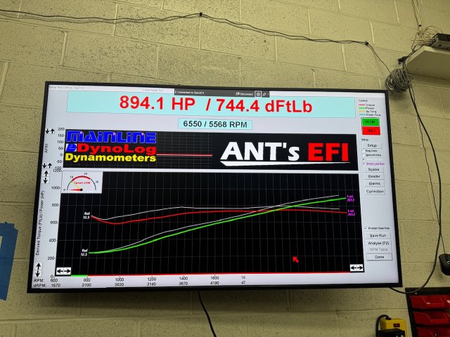

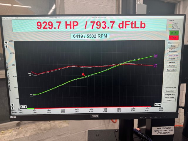

900 HP Hellcat Dyno pull.
