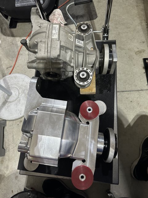

This little cart? Same one I use to swap my rear this weekend. Works like a charm. IMG_7909.jpeg
8,560
7,506
Yep! Same exhast
This little cart? Same one I use to swap my rear this weekend. Works like a charm. View attachment 116459
yep! Same exact one. I use it for the transmission and exhaust too
