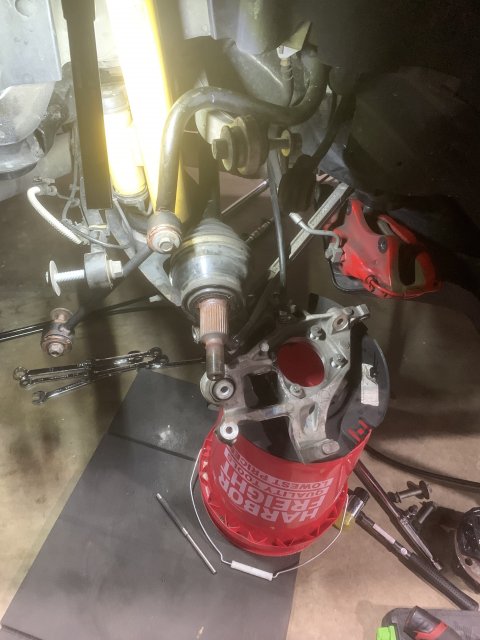

Axle broke inside the diff. Yay! Stock demon axles.

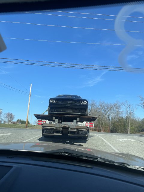

That really sucks man, you’ll get it back together quickly. Hoping you have a trailer at least, my junk would have to be towed home from track
You mean like this…
25CF2B92-DC1C-4046-B5F8-2CF4AD08004A.jpeg B7BD59A1-D12C-4BA7-A870-70157813F0AB.jpeg
my trailer is at a friends house
8,745
7,679
You mean like this…
View attachment 99366 View attachment 99367
Shoulda had your friend bring your trailer! That sucks man, a lot of us have been there. I haven’t yet, but sure plan to be. Did you have to pay a tow truck or does triple A work for a track tow

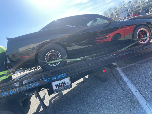

The carnage

Buddy at the power level and shooting for the numbers you are, bring the trailer every time.

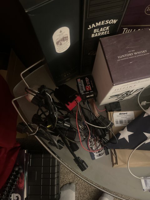

How are you holding rpm so steady? Do you have stage 6?
Many years of foot braking practice, my stage six is sitting by my whiskey collection

I bet ya he already has new axles in. I’m undecided on the quickest way to swap them out. I’ve seen people lower rear of exhaust, driveshaft at diff, undo diff and slide diff to the side. Not sure if it’s faster that way or the way I should have done it (still stock axles) which is taking rear suspension apart
When you get to the outlaws only way to do it is suspension. There isn't enough give to lower the diff and pull them out, found this out. Stock axles, demon and renegades will come out lowering diff. Gforce recommends taking suspension apart to do it to not damage them
8,745
7,679
Not damage them? I walloped on mine with a sledge hammer and punch to knock them back so I could undo hubs without temoving knuckle (removed them anyway). I’ve seen way too many posts about people having to send them back for rebuilds almost immediately
