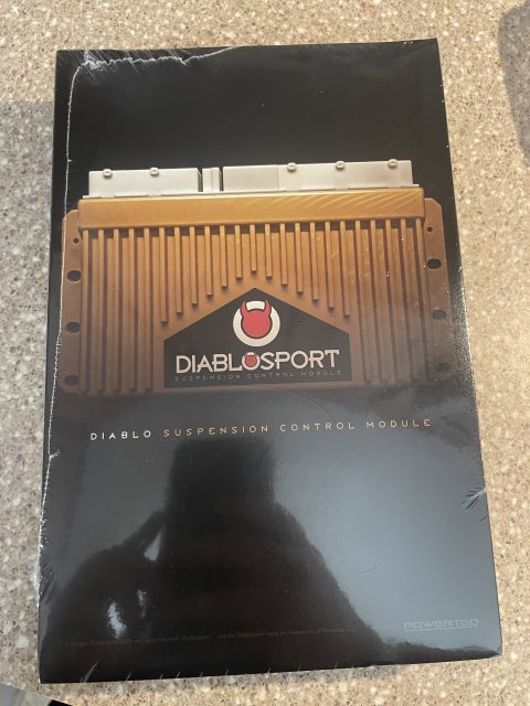

So on this is track mode for suspension what you want for drag racing? I’ve never been sure never really looked into it
4,149
10,438
Thread Starter #1,115
So long story short this is a private labelled DSC controller. Diablo Sport worked with DSC to dial in calibration files for drag racing. If you get the DSC controller it will be more geared towards twisty roads. It is programmable with Diablo’s software, not DSCs.

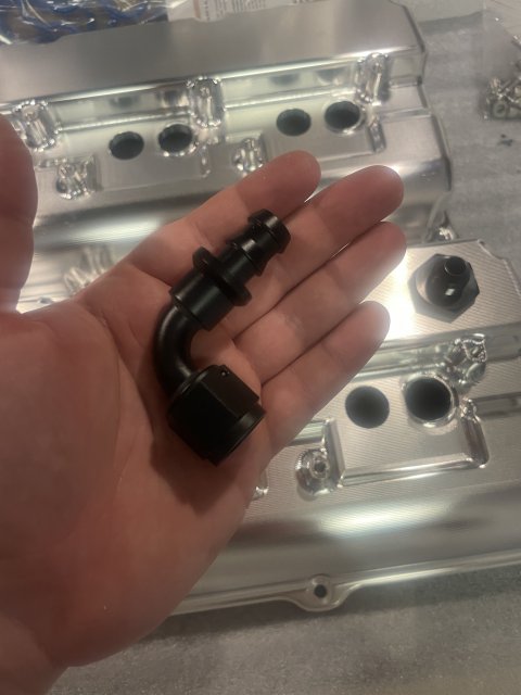

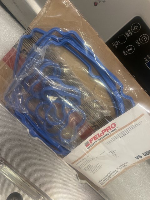

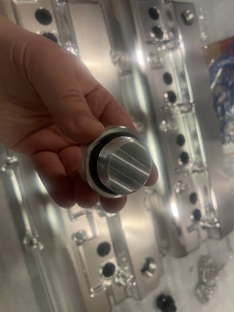

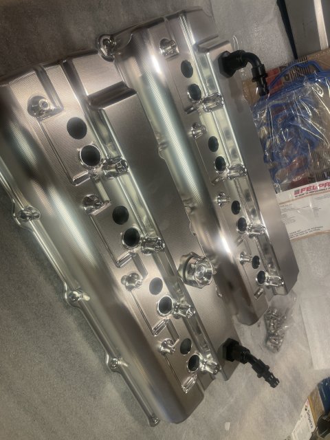

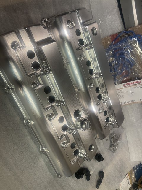

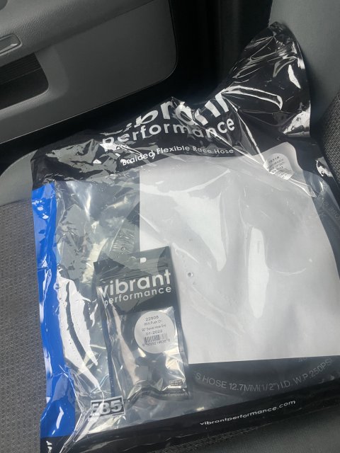

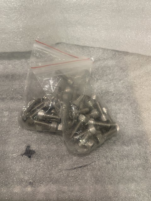

I love it when a plan comes together. These just arrived.
1C74ED6B-8FBC-4A70-8322-B96AB8E5FB7A.jpeg E25716DB-567F-48F3-AA79-A867AC7E4434.jpeg C8F4D822-261C-47F6-A09E-1593DCE8E4B1.jpeg 61B43E77-8298-46F3-A296-F2A3AA44267C.jpeg 28AA20D0-465C-4282-BBCD-5952230A7998.jpeg
purchased separately from Vibrant
12 orb to -8 an for the vents. The current JLT cans use 1/2” line. So I picked up a few -8 an fittings and hose. Helps a vibrant warehouse is two miles away and the guys like your hellcat.
i need some motivation to get this done :)
7,679
20,111
How do they help with plug changes?
4,149
10,438
Thread Starter #1,120
all the space… No goofy ass un-needed baffles.
