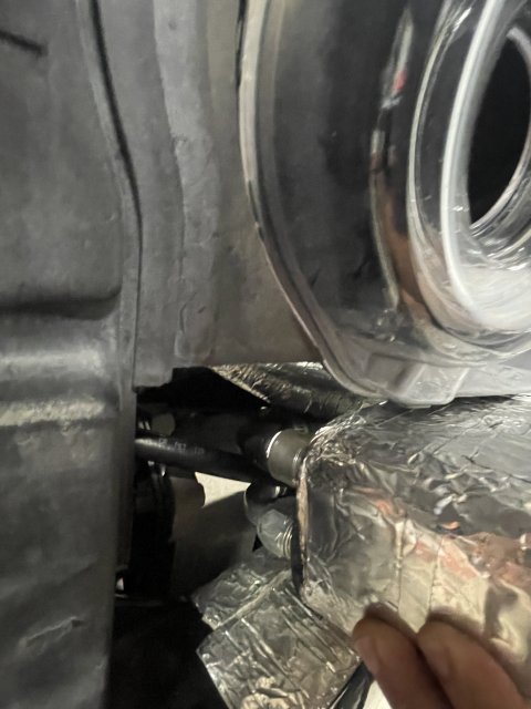

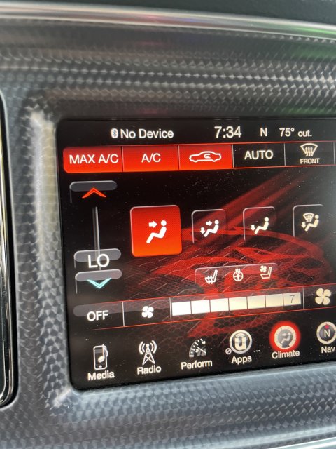

Killer chiller just said fuck you…
38817D6B-26A6-4977-BAC7-325292AF8013.jpeg 746E5940-C7A8-4273-96E2-D9D55DE548A4.jpeg
coolant flows, all valves open or close when commanded, ac blows ice cold when doing cabin…
i think im done, this is a sign to sell the car and get my ass to florida

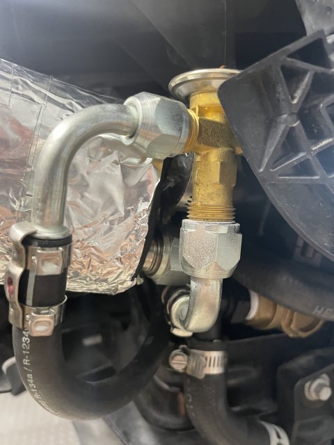

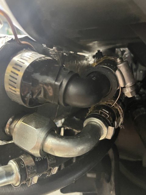

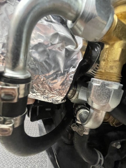

How is the orientation of the unit? Can you post a picture of the Freon in and out lines orientation to the ground? The outlet needs to be on the bottom not the top or it can fill with liquid Freon and not evaporate correctly, worst case not even flow, ie not get cold then.
4,130
10,402
Thread Starter #830
It is oriented down as per Kincaids instructions.
33E1D273-8218-4242-9A1D-CC69F95470D7.jpeg D9F32D88-42E8-4C6D-86A7-4B22CF095666.jpeg B5B2A86F-EF4F-4610-953B-F4AC6AA31313.jpeg
3,819
9,045
Yea, looks right from pictures posted. Does the pipe and hose on the bottom of the TXV valve get cold during operation?
4,130
10,402
Thread Starter #832
bottom line coming from ac compressor with drag valve closed is cold
only thing I can think of is serious airbubble in the lines or the unit is bad. :(
3,819
9,045
The only moving part in it is the TXV valve the brass colored device. Out of the bottom of it going to the heat exchanger itself should get ice cold. If it’s not it’s not letting liquid Freon go through it or there no liquid Freon there. Did you check the charge pressures?
